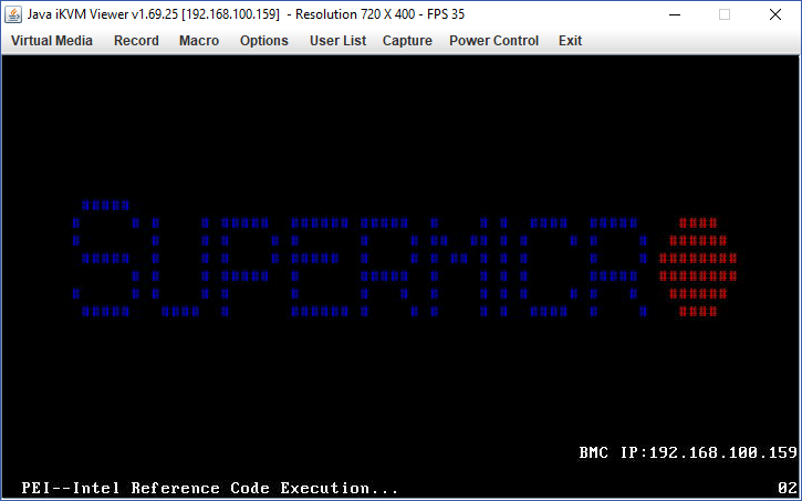

Yesterday morning my freenas machine was beeping (5x short beeps 1x long - Supermicro board) and stalled at boot (PEI--Intel Reference Code Execution... 02). Online suggests a memory error yet in the IPMI it was still happy to tell me both RAM modules were present and what they were.
After work yesterday I took one RAM module out and rebooted.. same issue on boot. Swapped the module to the other slot and it booted up but sounded like it restarted at some point (I was in my loft and no console so going off the sounds of the drive spinning down etc). Logged in via IPMI and saw it was booting up and seemed to be working fine.
Shut it down and put both modules back in and it rebooted ok again however just after it imported the volume it restarted (which I suspect it did before I just wasn't in front of a monitor to catch it). After that it was ok.

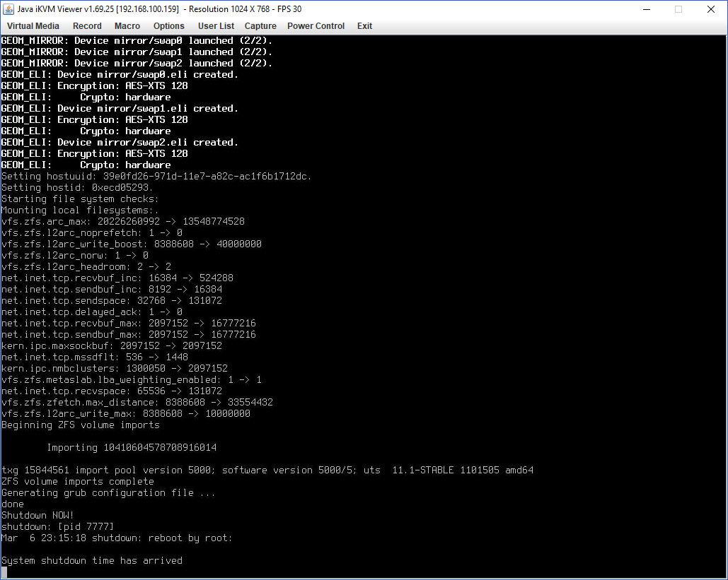

I've got some screenshots of the bios screen when the beeps were going (memory beeps.png) and what the console showed when it triggers the restart (server restart.png) - there's nothing particularly helpful though...
ZFS volume imports complete
generating grub configuration file...
done
Shutdown NOW!

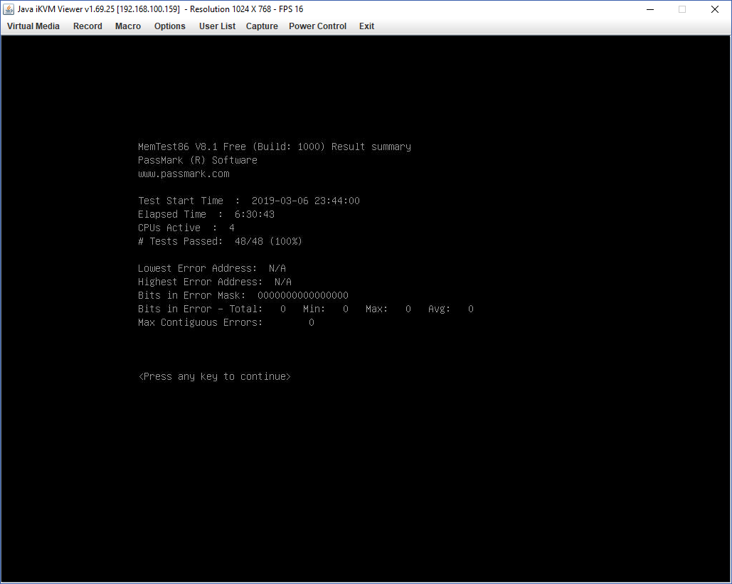

I ran memtest overnight (see memtest pass.png) which passed.
