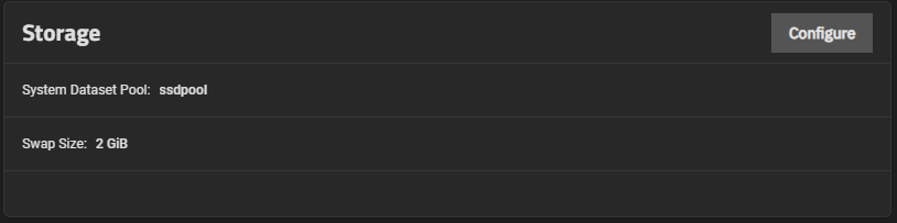

The system dataset can be relocated to the "source" pool as well through the System -> Advanced -> Storage -> Configure option if that wasn't intended:
