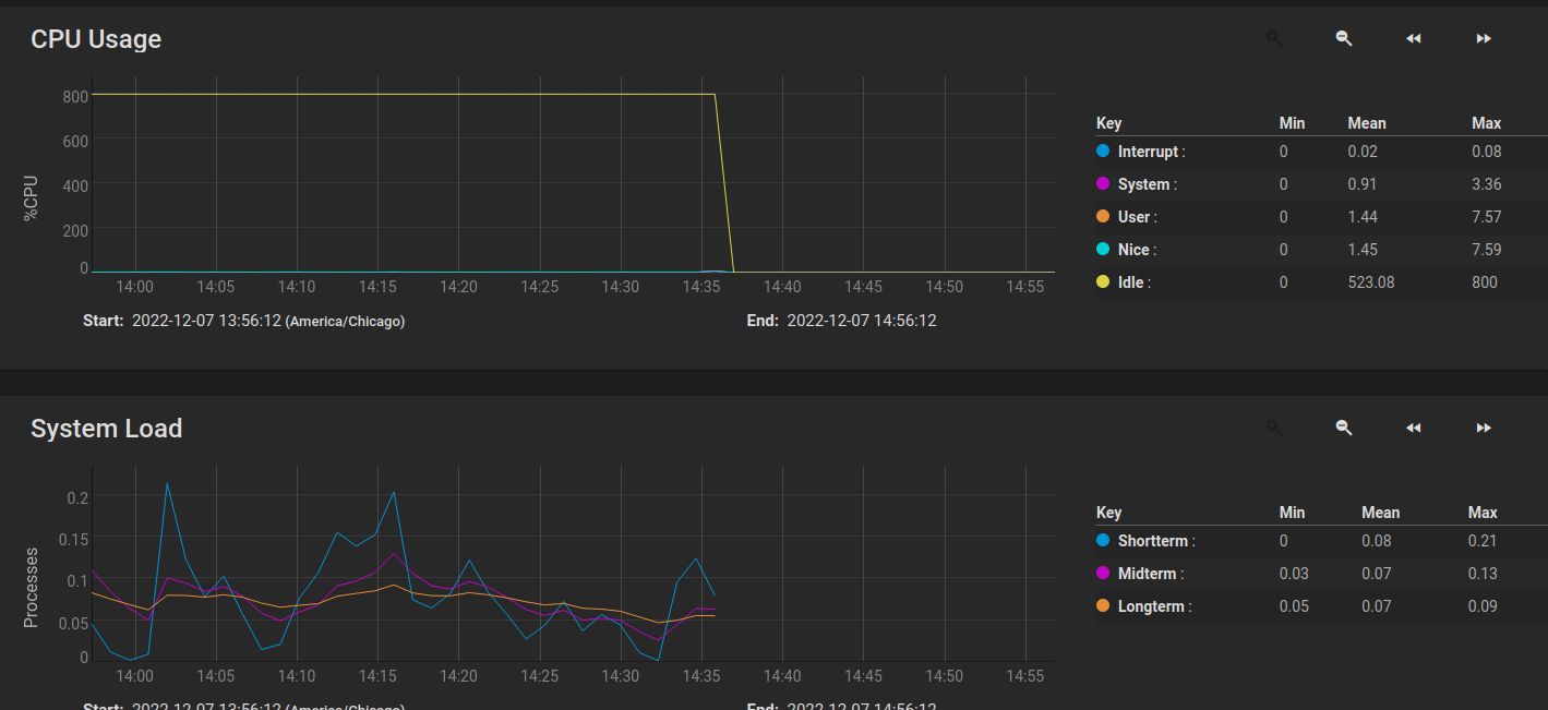

Well, I confirmed nothing was going on. When I got home, I could log in without issue. I also got another reboot at 5pm today. Turning off the UPS did not seem to change anything. I have not shut the NAS down for cleaning, but there is nothing untoward on the main page when it appears to go down (at 14:35 the data streams stop). It is strange that it does not come back until 5pm:

It looks like the CPU was at ~45C but at 800% 'idle' when it went down. It certainly looks like nothing going on. Is 45C bad? I have not yet run memtest, but that will require a bit of contortion as it runs headless and I'll have to get a monitor and keyboard over to it. Could it be that the clock gets out of sync? I do not think it went down at 14:35 then took until 17:02 to come back. A reboot usually takes on the order of seconds, not hours.
