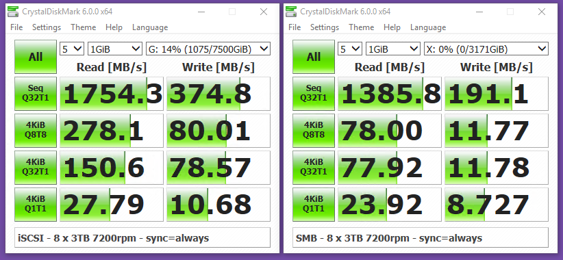

Hmm... the more I think about it the more I think that the SLOGs aren't actually the problem and I'm blaming them incorrectly... Anyway, here's the performance I get using them currently...
Is it normal for iSCSI to be *that* much faster vs SMB? Is there anything I can do to optimise SMB performance, specifically the 4KiB reads/writes?
Thanks for the advice, I'll read Stux's thread again and see if I missed stuff or misunderstood (entirely possible)
