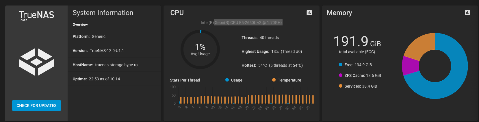

I have forgot to say that during transfer the processor is at about 1-2% and free the memory is at 134 GiB

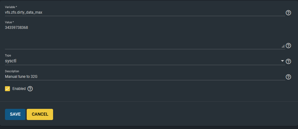

Assuming you have the SLOG added correctly, you may need to tune the dirty data max value. Remember that this could leave you vulnerable to power failures or anything else that crashed the system hard.

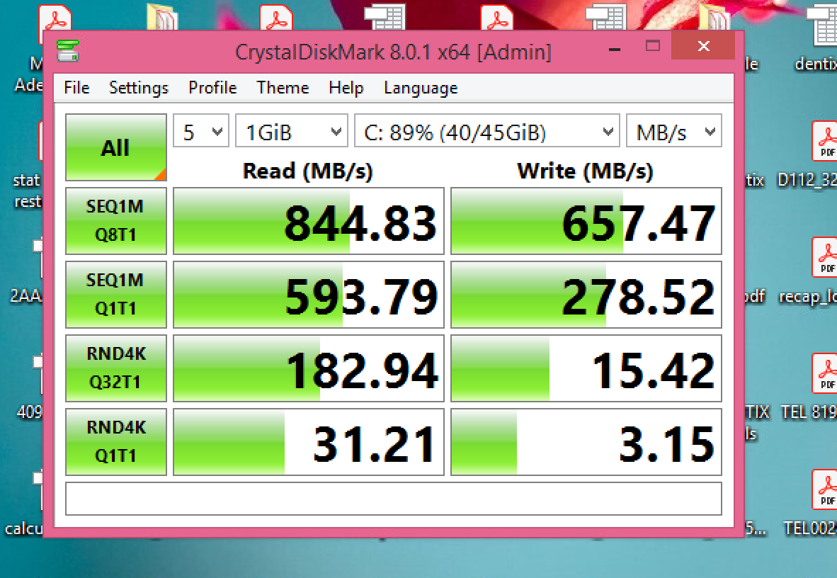

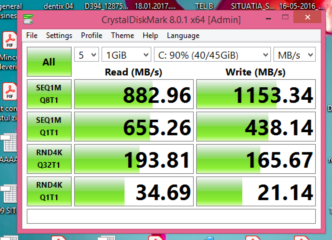

Thanks for the info the current setup with the current hardware under Truenas was getting this performance:
With the hardware raid:
The test was done from an other servers connected to the storage server with NFS share and direct SPF+ connection.
For the moment until I get an HBA card compatible with TrueNas I will use the existing setup.
Also I have a question on what to expect with an HBA card. Will it be close to the HW Raid Speed?

I've done tuning recently myself. I'll share my findings:
Also bump up your file size to 16GB once you are close to being tuned. You will likely see your numbers drop (caching).
