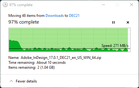

Every transfer starts out 800-900MB/sec then within 5-10 seconds falls to 250-350MB/sec for the rest of the transfer.

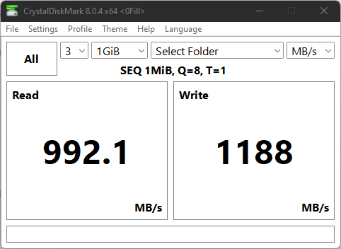

CrystalDiskMark test always comes out about the same. But I do know this is misleading as it reports the fastest speed at any point of the test.
With limited knowledge in this field, I am at a loss as to why the speed drops off.

If you test by copying files, you are limited in throughput by the number of I/Os that are outstanding (queue depth). Its a copy limitation.
Early on, its Ok because the writes are acknowledged when in RAM, but after you hit the RAM buffering limit, the systems has to wait for I/O's to be committed to the drives.
Test with fio and you can see write and read bandwidth with many I/Os in flight (queue depth = 32). Its less latency sensitive.

1st of all.. confirm that independent read and write performance is OK.
Then confirm that copy is slow.. and hence the theory is correct
