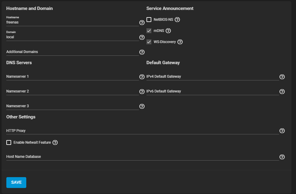

I alos have the same issue with Sonarr and any plugins I install for that matter, Ive tried so many different network configurations and cannot for the life of me work it out, Global configuration is all automatically set - True Nas can down load updates and connect to the internet fine but any plugins I install do not seem to access the outside web. Sonar will not allow importing any of my tv shows as it cannot connect to the server to confirm the status. :(
youngspark
Apr 30, 2022
Global config
