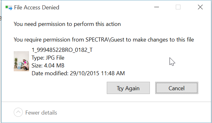

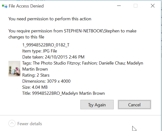

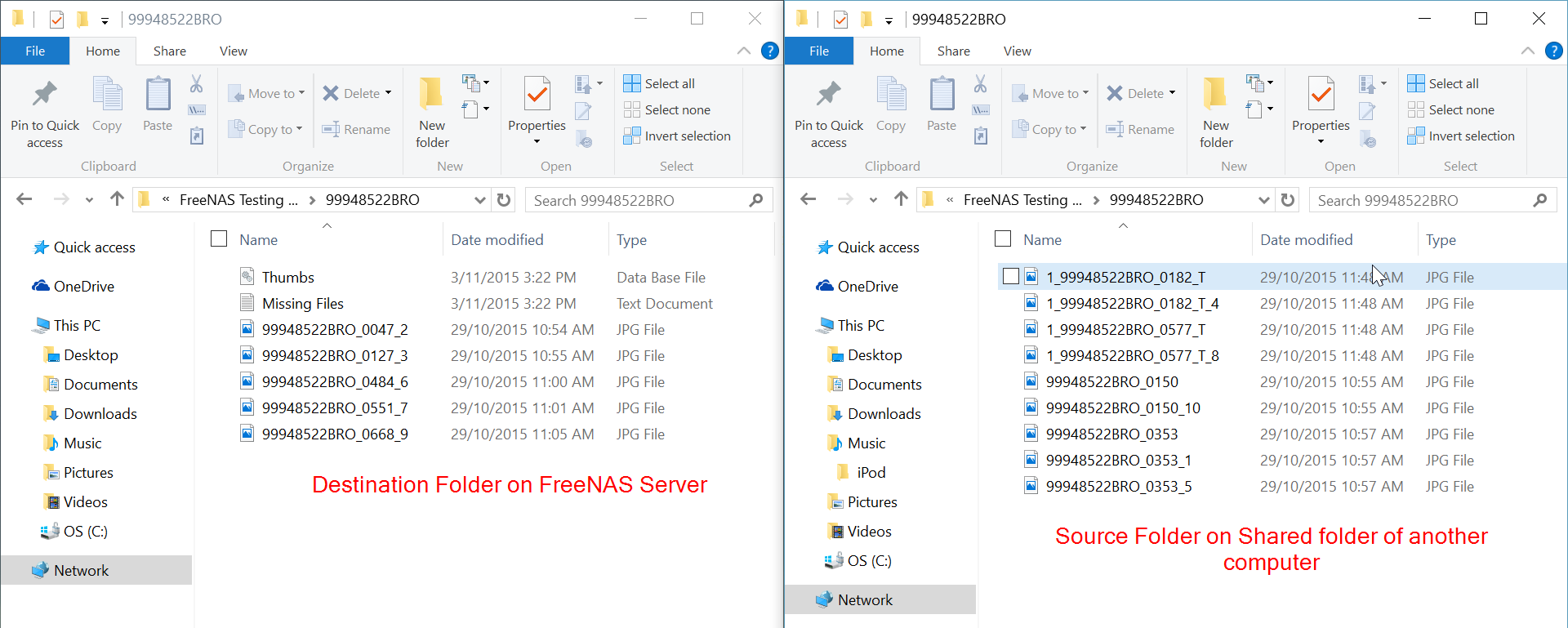

What seems to be the strangest thing to me is that some files do transfer across fine while others return the error message.
I have attached a few screenshots. Hopefully this helps. As you can see in the screenshots approximately half of the files are able to be transferred successfully, the other half cannot be transferred.

Based on the screenshots the error is stemming from the source of the file on other people's computers, not freenas
