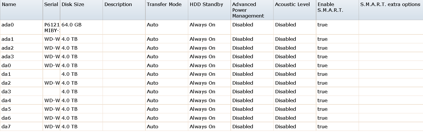

Some of my servers' drives do not get included in the regular smart tests, even though all drives are selected the same way in the corresponding dialog.
This coincides with the respective drives' serials not being listed (see attached screenshot).
The tests that are listed are probably the ones I did manually when I set up the server.
Notice that my chosen firmware (P18) does not match the driver version of Freenas, which could be the root cause.
ada1, ada2, ada3, da0, da2, da4, da5, da6, da7
# 1  Short offline       Completed without error       00%      1196         -
# 2  Short offline       Completed without error       00%      1028         -
# 3  Extended offline    Completed without error       00%       894         -
# 4  Short offline       Completed without error       00%       860         -
# 5  Short offline       Completed without error       00%       693         -
# 6  Short offline       Completed without error       00%       525         -
# 7  Short offline       Completed without error       00%       358         -
# 8  Short offline       Completed without error       00%       213         -
# 9  Extended offline    Completed without error       00%       175         -
#10  Short offline       Completed without error       00%        83         -
#11  Short offline       Completed without error       00%        54         -
#12  Extended offline    Completed without error       00%        47         -
da1, da3
# 1  Short offline       Completed without error       00%        83         -
# 2  Short offline       Completed without error       00%        55         -
# 3  Extended offline    Completed without error       00%        47         -
OS - Freenas 9.2.1.4.1
MB - X10SL7-F with the sas-controller flashed to 9207-8i-P18-IT
HDDs - Wd Red

This problem seems to creep up quite often, especially with additional controllers.
I suggest you create a bug report on bugs.freenas.org and usually this kind of bug can be fixed rather quickly, provided you allow one of the developers debug access to your machine or give them all information they request.
