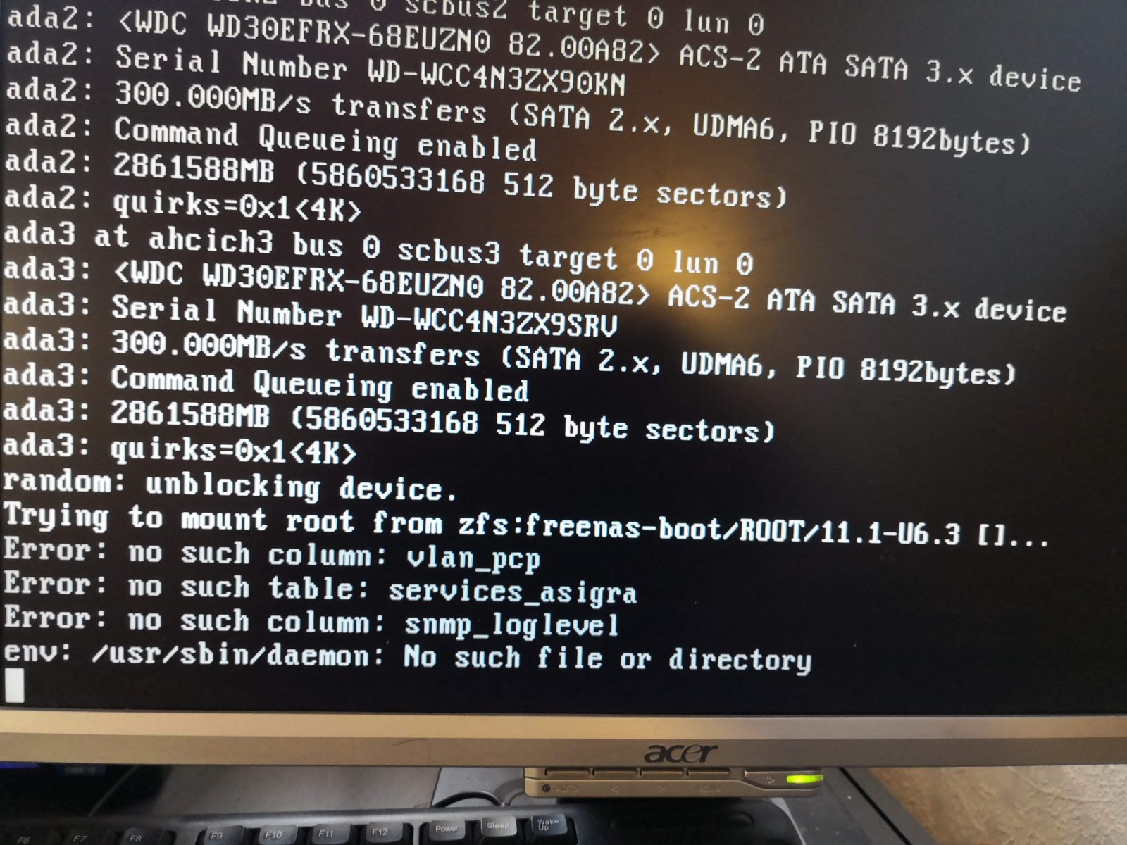

I tried to upgrade my V9 installation last Christmas to V11.1-u6 and ran into big scare problems. I've lost webb GUI and none of my SMB shares was accessible from the network. I've managed to restore and remove the V11 update from my system. I set the V9 to boot and made sure none of the V11 files would be any problems.
Now to the problem. I recently had a major power loss and my UPS cut the power to my network causing a 2 hour outage. After the system went online everything seemed alright but... Murphy's law is at it again. Somehow some of the V11 files managed to survive and spread into my system like a virus and causing this bloody thing.
I'm not sure why releasing a upgrade that causes more problems then it solves :mad:
Can anyone help me figure out how to get the system to boot into my V9 installation and remove these V11 bloody files and folders.

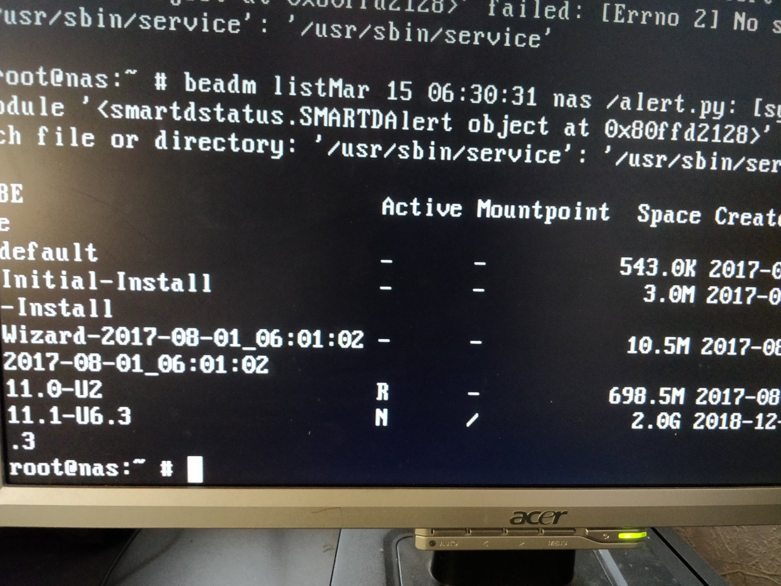

No not yet. I now have access to the server on-site and gain shell access, have listed installed versions of the FreeNAS software and got me a real surprise or not. V11.1 has removed my V9 installation somehow despite that I removed v11 from update list and boot list after last time I tried to update. I had the V9 option in this list last time.
Instead I have V11.1-U2 as option in this list. Se picture for readout. So where did my older version go?
I get webb login screen but when logged in nothing is showing on the webbpage, cant do anything from there.
