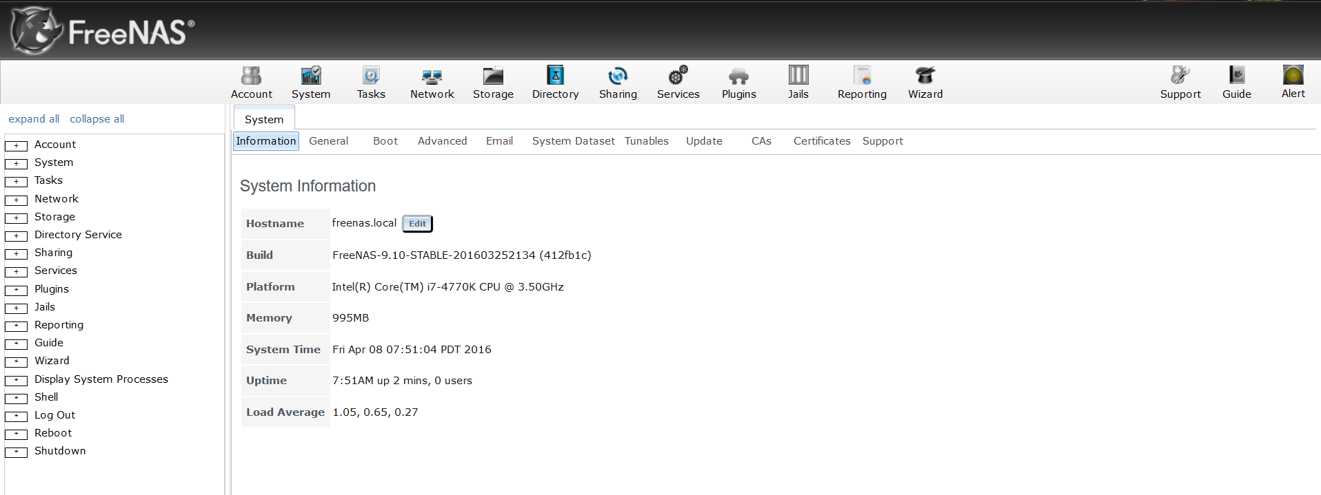

Even in the VM 9.10 looks like this:
Does this looks correct to you?

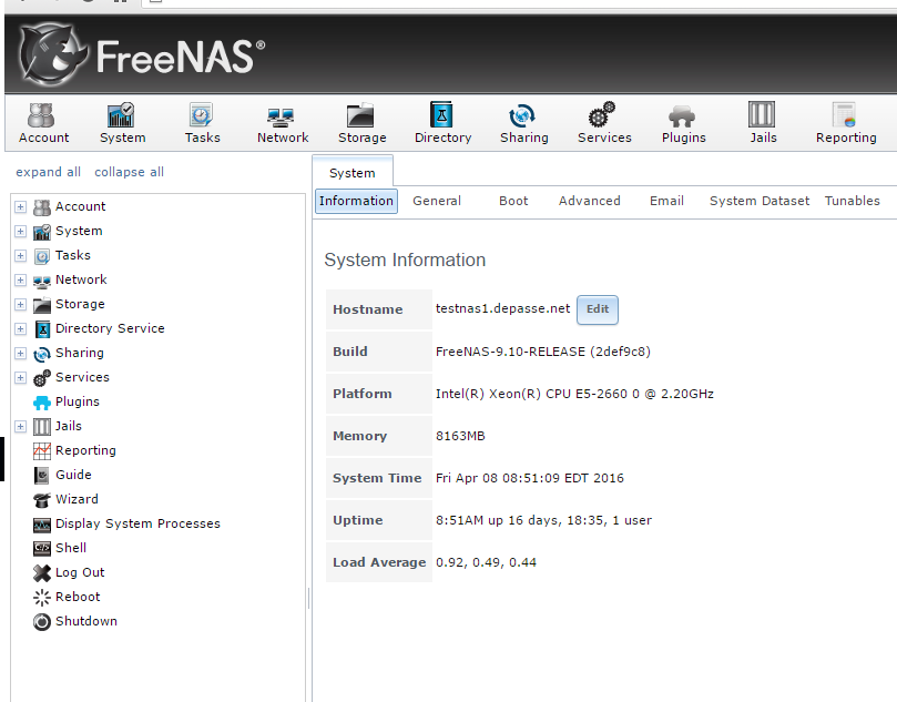

depasseg
FreeNAS Replicant
Sep 16, 2014
2,874
Castigo
Oct 28, 2015
30
thanks for the snapshot man. The builds are different... I got mine from the download page @ freenas...
May I ask when did you get yours? Did you update from the GUI?
depasseg
FreeNAS Replicant
Sep 16, 2014
2,874
It was an up to date 9.3 that was then upgraded to 9.10. This upgrade was right after 9.10 was released, and it has not been updated since.
I meant to include that info in my post with the picture. :smile:

Castigo
Oct 28, 2015
30
Yes, I do actually, on both Chrome and Firefox. I see your point, I'll try disable them all and see what happens! ;)

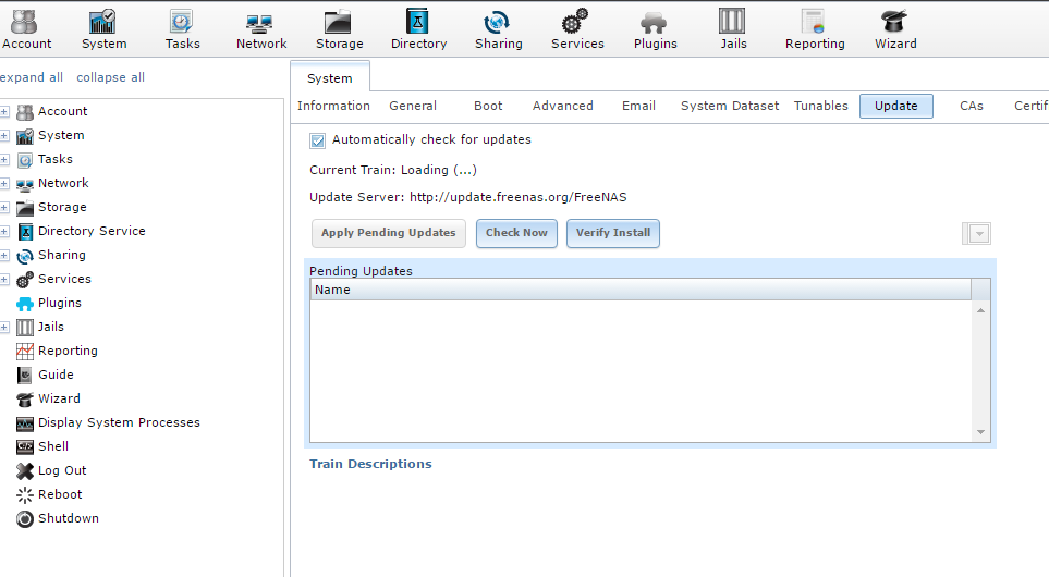

Castigo
Oct 28, 2015
30
And here we go:
I'll have to find which one is the culprit, but now it all looks allright in the VM!
Excellent! :)
