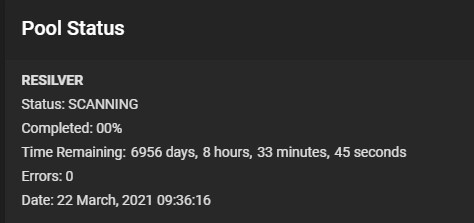

StefLag67
Mar 21, 2021
16
holly sh**!! See you guys in 19 years

@StefLag67 Erwwwww ... i smell SMR drives? Can you give us the HDD model numbers ?

What is the current time remaining? If it is still very long it could be that the faulty HDD is simply dying and the resilver process is desperately trying to read the data from faulty HDD. In situation like this the speed can be a veeeeery slow.
So ideally give us output of smartctl -a /dev/xxxx for both (all three?) drives as well as zpool status <poolname> and maybe also the verbose output zpool status -v <poolname>.

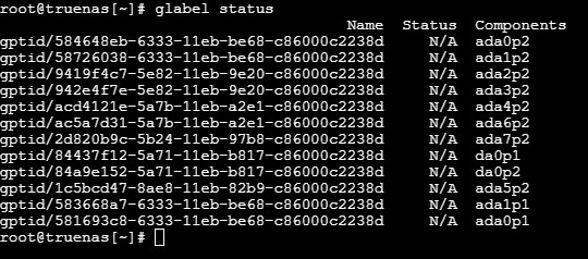

Ok so the "WD30EZRX-00D8PB0" is wasted that is clear. Can you give output of glabel status

@StefLag67 Uhm ... plaintext pleaseeeeee (uhm why do people do this ... posting screenshots of pure text :/)
One more output of this please : camcontrol devlist
didn't manage to copy the whole plain text, apologies... here you go:
root@truenas[~]# glabel status
Name  Status  Components
gptid/584648eb-6333-11eb-be68-c86000c2238d     N/A  ada0p2
gptid/58726038-6333-11eb-be68-c86000c2238d     N/A  ada1p2
gptid/9419f4c7-5e82-11eb-9e20-c86000c2238d     N/A  ada2p2
gptid/942e4f7e-5e82-11eb-9e20-c86000c2238d     N/A  ada3p2
gptid/acd4121e-5a7b-11eb-a2e1-c86000c2238d     N/A  ada4p2
gptid/ac5a7d31-5a7b-11eb-a2e1-c86000c2238d     N/A  ada6p2
gptid/2d820b9c-5b24-11eb-97b8-c86000c2238d     N/A  ada7p2
gptid/84437f12-5a71-11eb-b817-c86000c2238d     N/A  da0p1
gptid/84a9e152-5a71-11eb-b817-c86000c2238d     N/A  da0p2
gptid/1c5bcd47-8ae8-11eb-82b9-c86000c2238d     N/A  ada5p2
gptid/583668a7-6333-11eb-be68-c86000c2238d     N/A  ada1p1
gptid/581693c8-6333-11eb-be68-c86000c2238d     N/A  ada0p1
root@truenas[~]# camcontrol devlist
<ST4000VN008-2DR166 SC60>          at scbus2 target 0 lun 0 (pass0,ada0)
<ST4000VN008-2DR166 SC60>          at scbus3 target 0 lun 0 (pass1,ada1)
<WDC WD30EZRX-00DC0B0 80.00A80>    at scbus4 target 0 lun 0 (pass2,ada2)
<WDC WD30EZRX-00D8PB0 80.00A80>    at scbus5 target 0 lun 0 (pass3,ada3)
<ST31000340NS SN03>                at scbus6 target 0 lun 0 (pass4,ada4)
<WDC WD60EFRX-68L0BN1 82.00A82>    at scbus7 target 0 lun 0 (pass5,ada5)
<Hitachi HDS721010CLA332 JP4OA3GH>  at scbus8 target 0 lun 0 (pass6,ada6)
<WDC WD10EZEX-60WN4A0 01.01A01>    at scbus9 target 0 lun 0 (pass7,ada7)
<AHCI SGPIO Enclosure 2.00 0001>   at scbus10 target 0 lun 0 (pass8,ses0)
<Generic- SD/MMC 1.00>             at scbus12 target 0 lun 0 (da0,pass9)

Thanks ... I am a bit confused with the zpool output.
The new 6TB is ada5 (WD60EFRX-68L0BN1)...
And as per your zpool status
gptid/9419f4c7-5e82-11eb-9e20-c86000c2238d ONLINE 0 0 0
// This one is ada2 (WD30EZRX-00DC0B0) which has OK SMART
gptid/942e4f7e-5e82-11eb-9e20-c86000c2238d ONLINE 3 0 4 (resilvering)
// And this is the faulty ada3 (WD30EZRX-00D8PB0) with bad SMART stats
So i wonder why the ada3 shows as resilvering ? I don't remember exactly how the zpool output looks like while resilver is in progress so it could be that it refreshes after it is done but your output is so confusing. It looks like it actually resilvering the ada3 from ada2 :oops:
