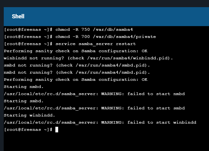

Try the following:
chmod -R 750 /var/db/samba4/
chmod -R 700 /var/db/samba4/private
then service samba_server restart

Try the following:

Send me the output of 'sh -x /usr/local/etc/rc.d/samba_server onerestart'
how can i get this info over its alot to print screen
