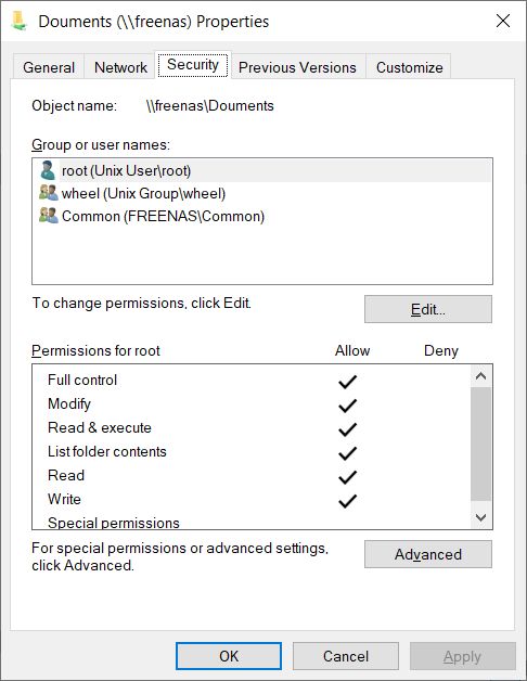

So, to continue, I found that when I was trying to add this group from Windows to the ACL list that instead of adding the group, even though I chose the group in the list (Properties->Security->Advanced->Add->Select a principal->Advanced->Find Now->Chose the "Common" with the group icon instead of single user) instead it added just the user and nobody had access.
I decided to rename the group (Delete and re-create with same GID), however, it's still listing the user and group as both "Common" in Windows.
I've restarted SMB, I've rebooted the server...nothing. I can't properly add the group through Windows because it's not showing the correct name and instead adding just the user.

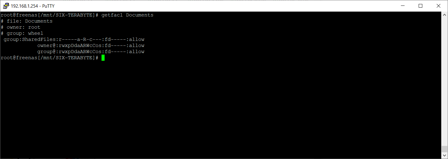

So, then I decided to play with setfacl on the folder to add the group manually in ssh. Success! The group has been added and users have read permissions!
Not so successful. When I go back to Windows and get the properties (thinking since setfacl doesn't have recursive abilities yet I'd use the "Replace all child object permissions") it still isn't showing the group name right.
While the SharedFiles group has been added to the directory and works perfectly for people to read the files, it is still not showing up properly under the security properties in Windows. Is this a Windows problem or a FreeNAS problem as far as refreshing the names? Any ideas on how to fix this?
When I try to replace permissions on child objects it does not work, instead it only copies the owner and group permissions. Could this be because windows is trying to set permissions for "Common" which doesn't exist? Or is this a known issue otherwise?
