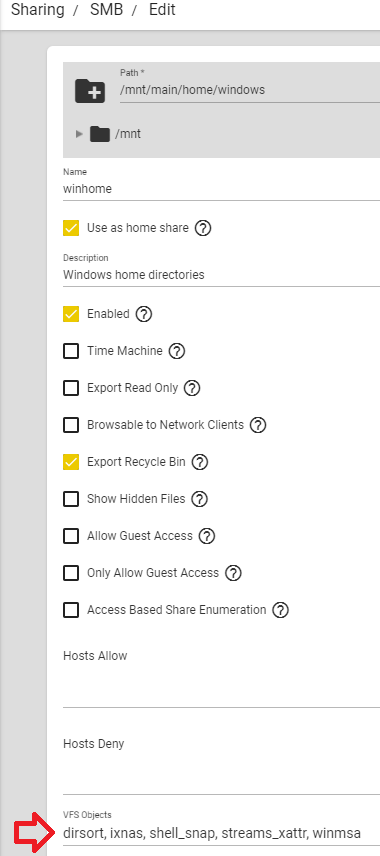

Edit the properties of your Time Machine share:

fruit:locking = netatalk
^^^ This feature in VFS fruit can cause the smbd process for the client session to crash. I don't believe I got the fix into BETA1, but it should be fixed in BETA2 and nightlies. Try removing the AFP share.

Unfortunately, the fix isn't in BETA1. So you will need to remove the fruit:locking parameter. I requested a debug file in your bug ticket so that I can investigate why the multi-protocol AFP/SMB config options are being added in your case.
