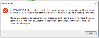

Not 100% sure what I am doing......
I have set the permissions for the folder as below.
It kept on asking for additional permissions & this was the list I had to use to get it to accept it.
Permissions set in the Shares
Windows doesn't work still. I put the password in & it gets an network error
