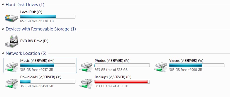

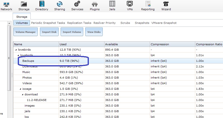

There are several SMB shares on a single FreeNAS box.
The "Backup" share (\\server\backups) says it's nearly full, with 9TB on it. Actually, it has about 16GB on it, not 9TB!
It was nearly full until I deleted 90% of what was there and it still shows as full.
I rebooted the server, no difference.
I have 2 screen shots below. One shows the shares as mapped windows drives, the other is from the FreeNAS dashboard "agreeing" with the Windows assessment.
BTW, as long as the screen shot is there, notice something else curious:
Even tho all shares are on the same server volume they all have different takes on how much free space they think there is. 450G, 957G, 368G, 9.3T, and 906G. There are (5) 3T RAID1-0 drives in the volume.
Either way, my backup will not run as it thinks there's not enough space!
Thanks, all
RG

I think the reason you have 9TB being allocated but may have only a few GB of files visible might be the result of the snapshots holding your data.
If you are fine with the state of yur backup, you could destroy some of the snapshot holding the most data.
