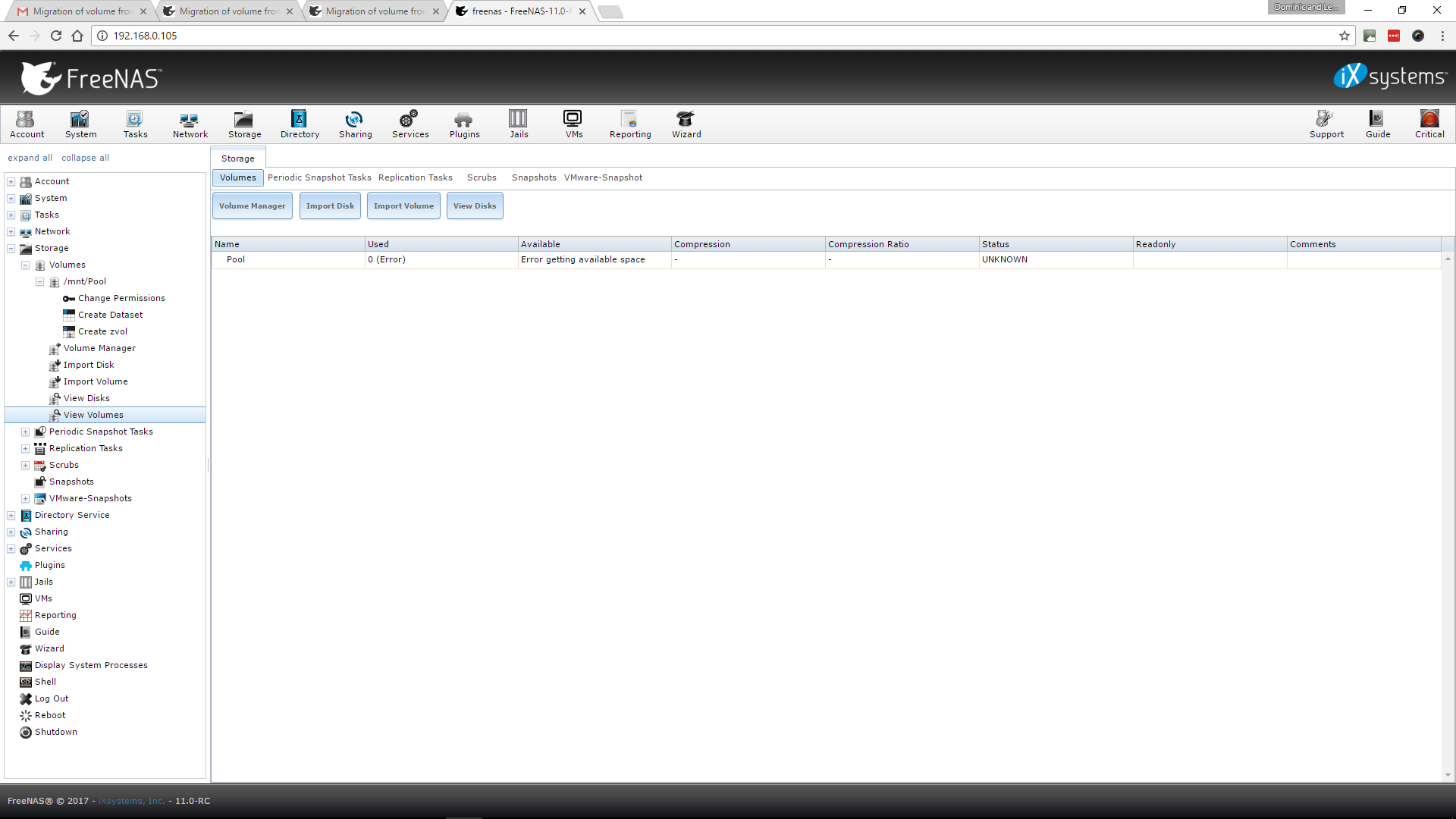

It appears on the home GUI page - there is a red flashing light in the top right hand corner marked "Critical".
When I go to Storage - Volume Manager I can see the disks but not the volume as I configured it under Corral.
what I am nervous about is configuring the disks as a new volume - presumably that kills all of the existing data?

Please post a screenshot of what you're seeing in Storage -> View Volumes.

Please see below
metal
May 6, 2017
12
It says
cannot open 'Pool': no such pool

15,504
OK, there's your problem. Your pool is called "Pool 1", while the GUI thinks it's called "Pool". Try detaching the pool in the GUI (click the pool at the screen you posted, then the icon at the bottom with a red X), zpool export "Pool 1", and then Import Volume from the GUI.
Edit: It's entirely possible that the space in the pool name is causing problems. Since you're going from Corral to 11, you're having to reconfigure everything anyway, so it'd probably be better to rename the pool. After doing zpool export "Pool 1", do zpool import "Pool 1" Pool1, then zpool export Pool1. Then do Import Volume from the GUI. The zpool import command will rename the pool from Pool 1 to Pool1.
Rename it to get rid of the space.

[root@freenas ~]# zpool export "Pool 1"
cannot open 'Pool 1': no such pool
[root@freenas ~]# zpool export "Pool1"
cannot open 'Pool1': no such pool
[root@freenas ~]#
That's because we missed something: You have a trailing space in the name!

Note the single space between pool: and Bender.
You'll need:
zpool export " Pool 1"

Robert Trevellyan
Pony Wrangler
May 16, 2014
3,778
I'm not seeing the difference in spacing. I see the first character of OP's pool name aligned under the first 'e' in 'root@freenas'. However, I wouldn't be surprised if the space in the name is causing trouble:
The pool name must begin with a letter, and can only contain alphanumeric characters as well as underscore ("_"), dash ("-"), and period (".").
Damn it, it's the state that's shifted for some reason. So much for that, and what a waste of an 11 000th post.
