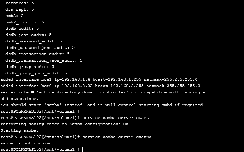

I have the following problem my freenas server was working fine but after restarting the SMB server it did not start automatically and the manual attempt to start the service only indicates that SMB could not start. Really new to Freenas so I have no idea what I'm doing.
Sep 21, 2020
5
What I can see is that in server role = 'active directory domain controller' it does not support running asmbd standlone, you have to start 'samba' instead, and go will control the start of smbd if necessary
But I try to start samba but it tells me that it is starting but it does not start
service samba_server start
performing sanity check on samba configuration: ok
starting samba
service samba_server status
samba is not running

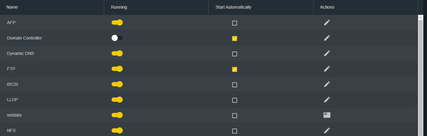

No. You have "start automatically" checked, which is equivalent to "enabled". This feature is removed in 11.3 so hopefully the unclear terminology is excusable.
