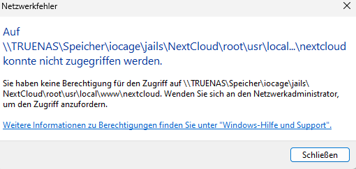

Can someone maybe explain to me how to get the directory:
/usr/local/www/nextcloud/data/
for me as a user via SMB, so that you can simply copy the things to the PC?
Info: I have released the path in which the iocage is located completely via SMB. I only don't have permission for the Nextcloud path via SMB, but when I want to change that, TrueNAS tells me that I can't change that:
Error: [EFAULT] [EPERM] Changing permissions on jail dataset paths is not permitted: /mnt/Speicher/iocage/jails/NextCloud

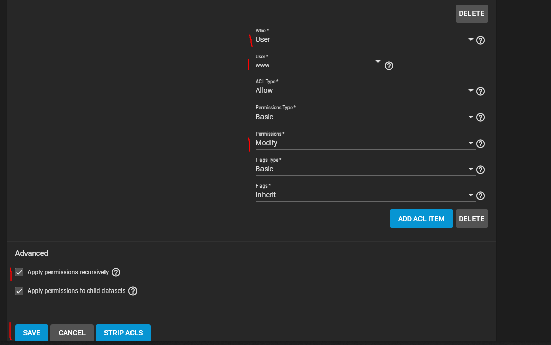

Make sure www user has access to the Dataset you want to share.

Eigentlich doch einfach, doch die Freigabe per SMB wird immer verweigert, mit der Info, dass dies nicht möglich sei.
Ich sehe ja den Ordner, habe aber keinen Zugriff darauf.

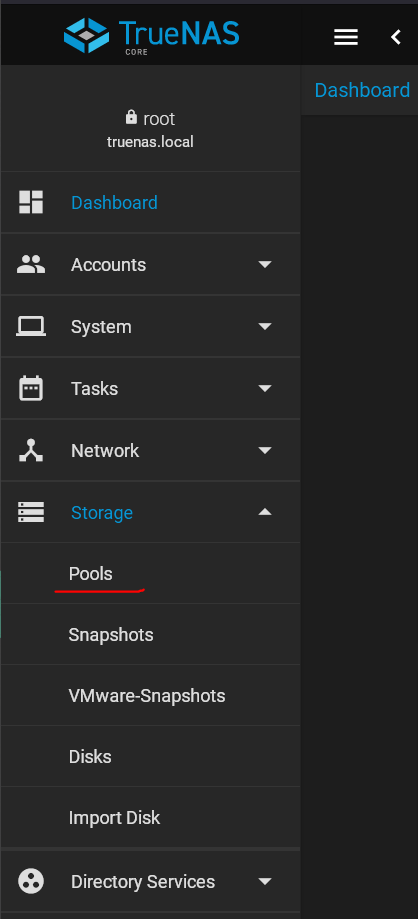

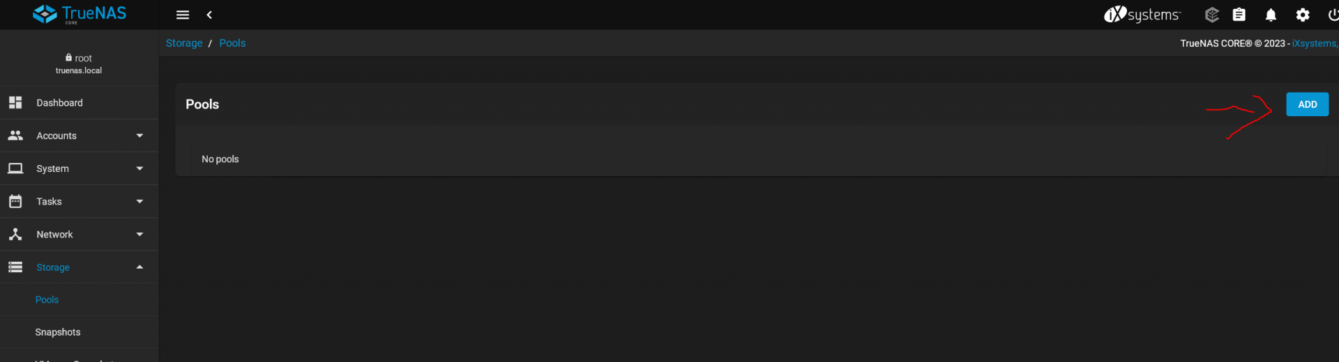

First thing is go to Storage -> Pools:
There you probably already made a pool.
Just in case I'll show you.

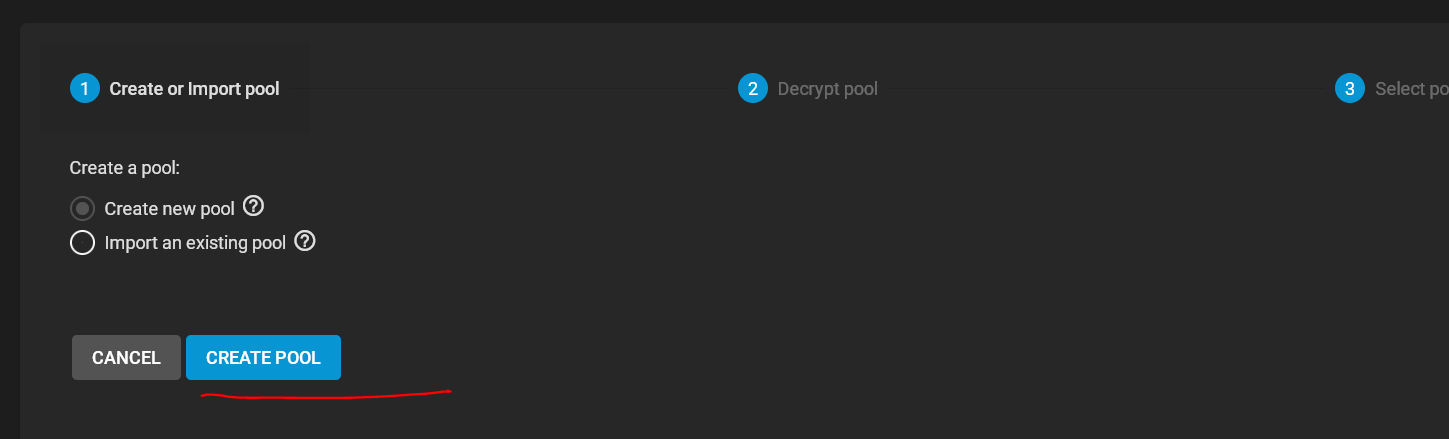

Click on "Add":

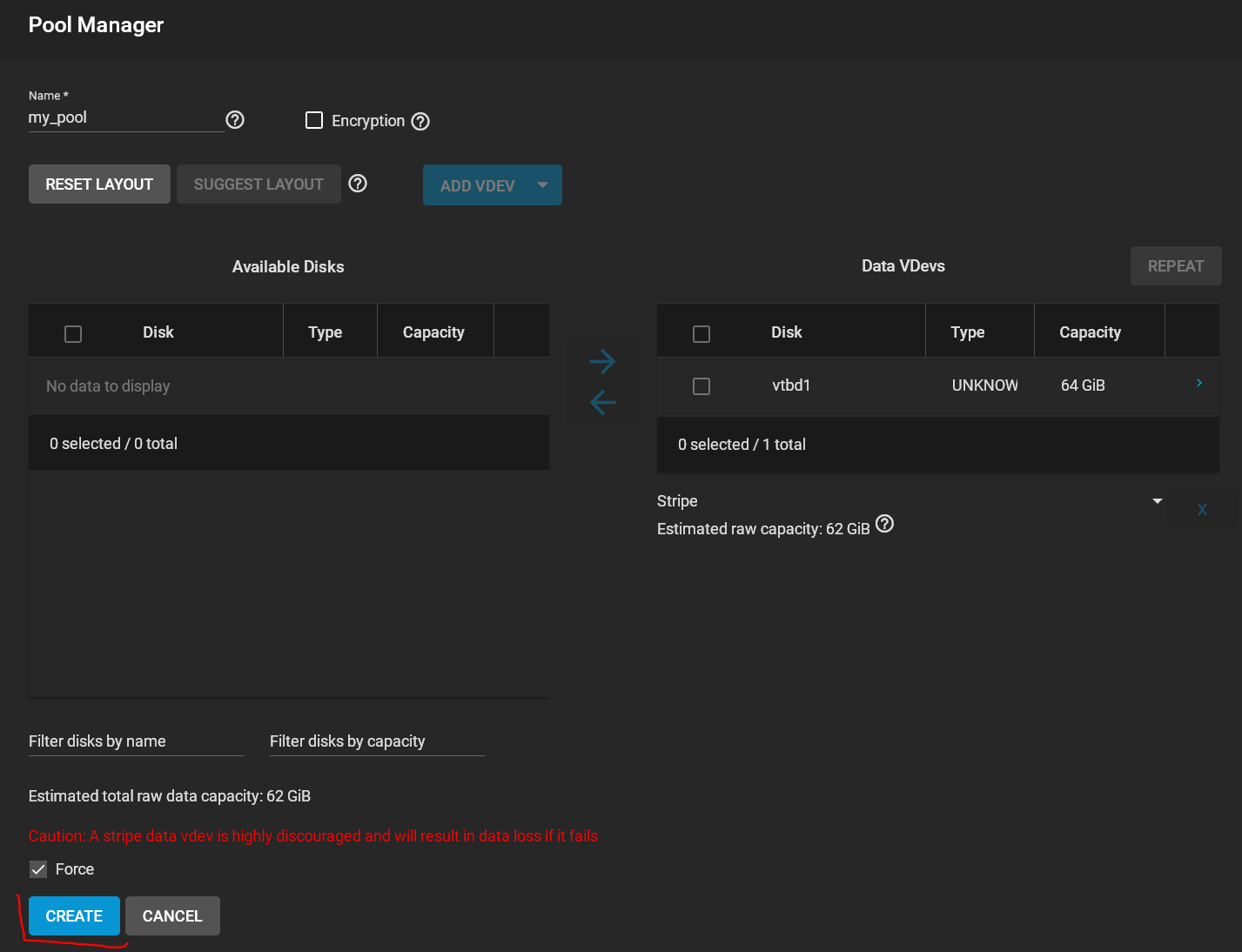

Then Create new pool:
Add the disks in the layout you want. For example if you have 6 HDDs then go for one VDEV in a raidz2 config.
In case of 4 disks just make to mirrored VDEVs.
My virutal machine only has one drive so I just add that:
And hit create.

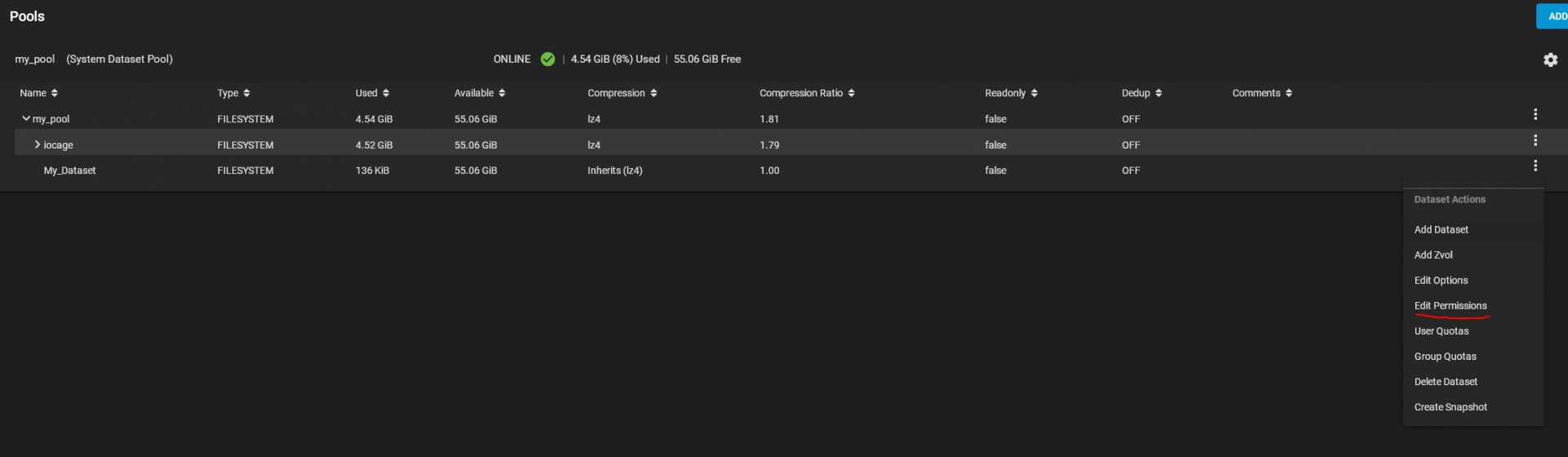

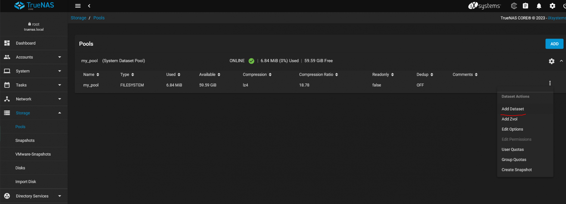

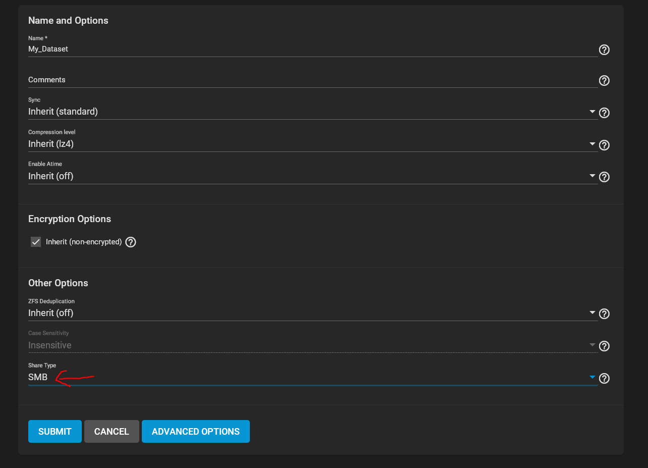

Now we have a pool, but we need a dataset to actually use it:
Let's just keep the defaults except ShareType. This should be set to SMB as we plan to share it later:
Then hit submit.

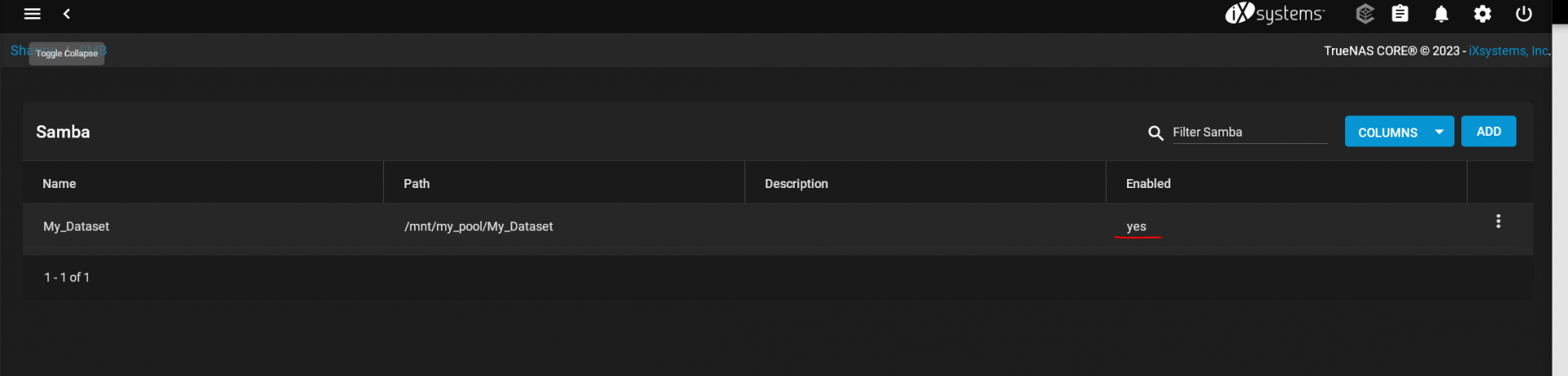

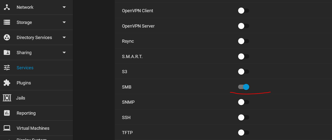

Now what we want do is make our dataset accessible via SMB.

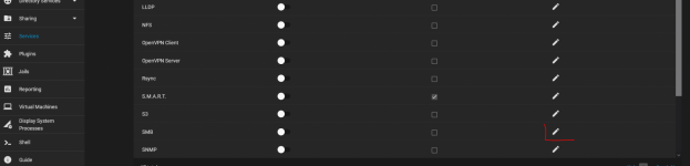

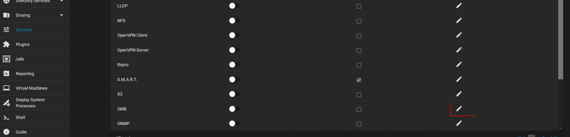

To do that we go to Services -> SMB -> start:

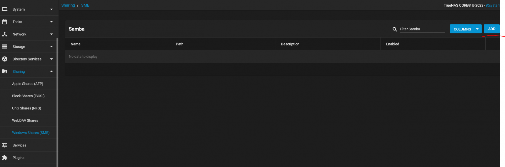

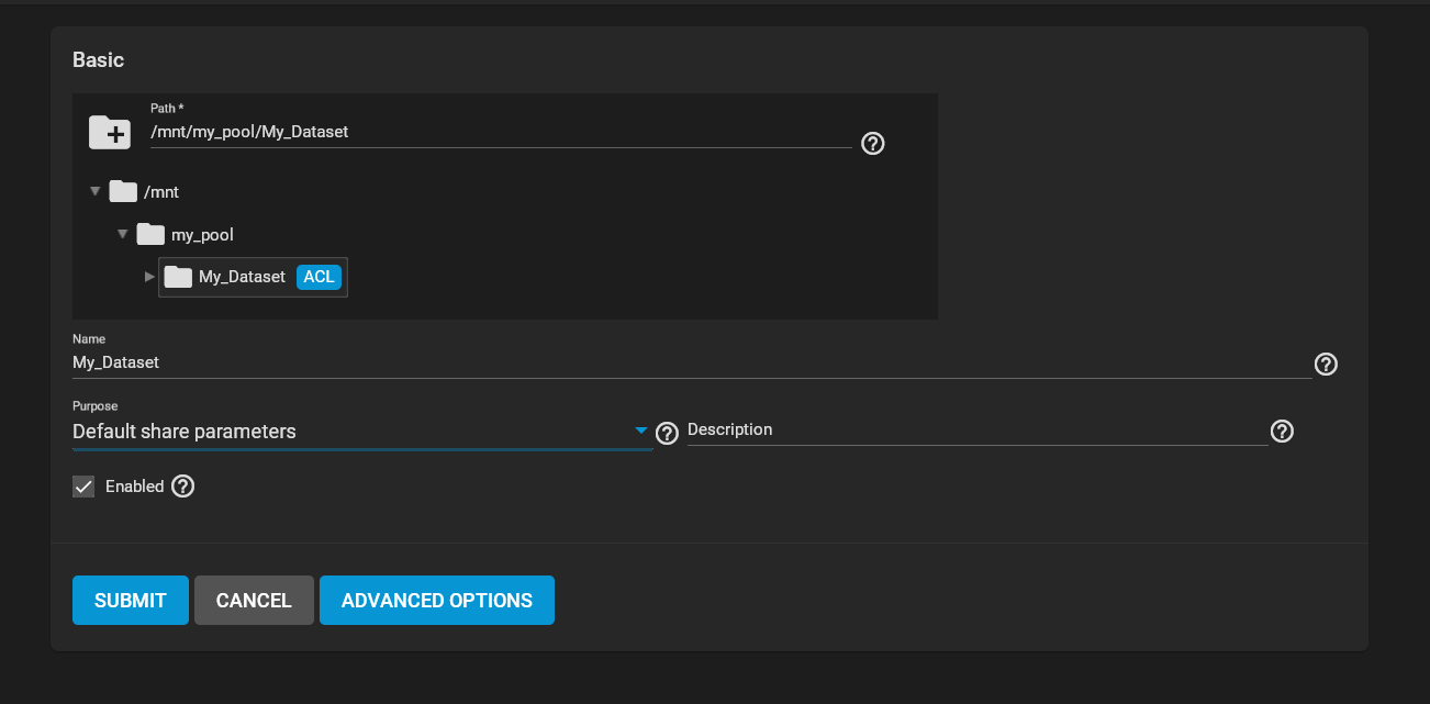

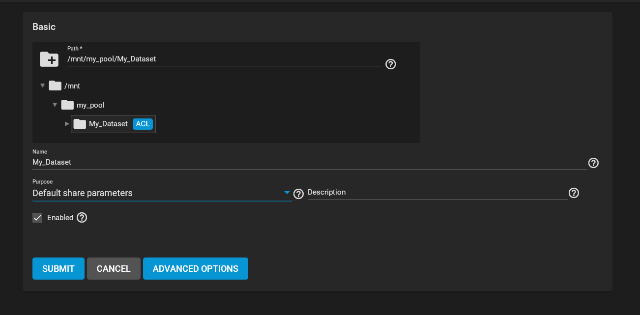

Then go to Sharing ->Windows Shares (SMB) and click add:
Select the dataset you want to share via SMB. Default options should be fine as they are. Then hit Submit.
It will tell you that it will auto enable the SMB service. Click okay you should now see the SMB share up and running:

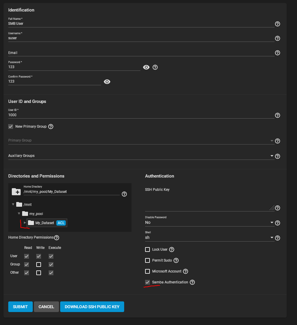

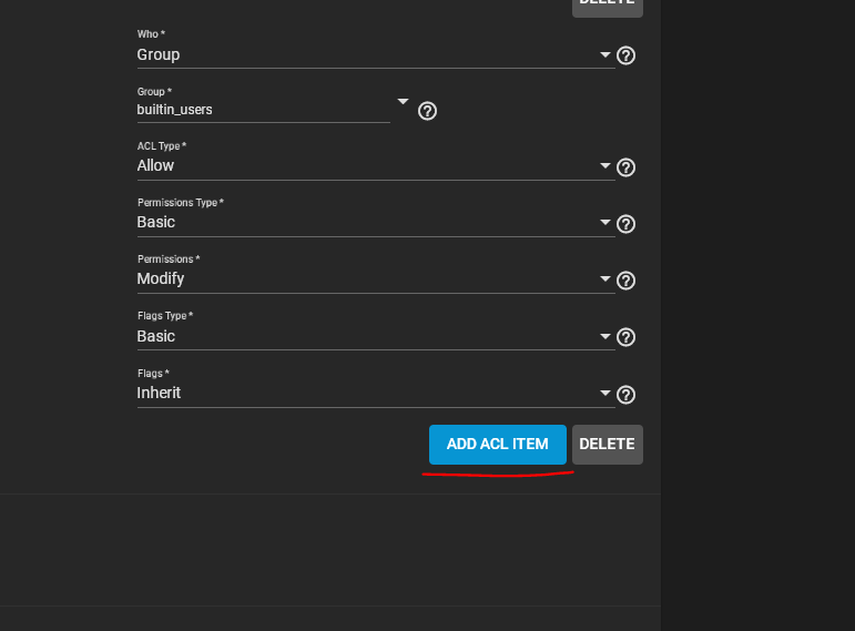

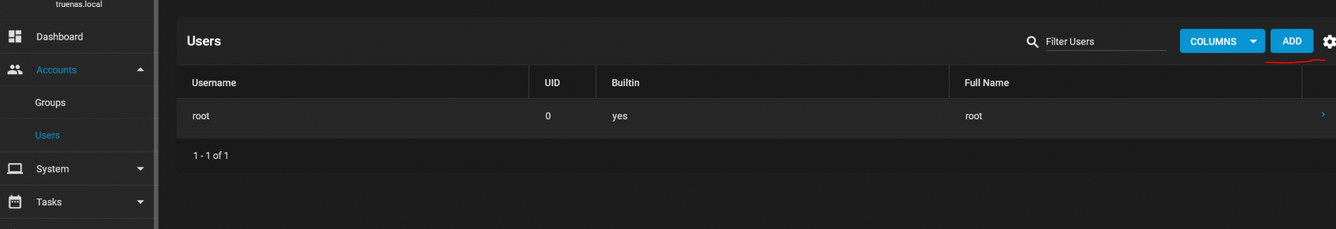

Now we need a user that actually has access to the SMB share. So we go to Accounts -> Users -> Add:
select a username, a secure password that you want to use as authentification for SMB and under Directories and Permissions we select what dataset we want to have access to. In My case I jsut chose My_Dataset as it is the only one available:
Then click submit.

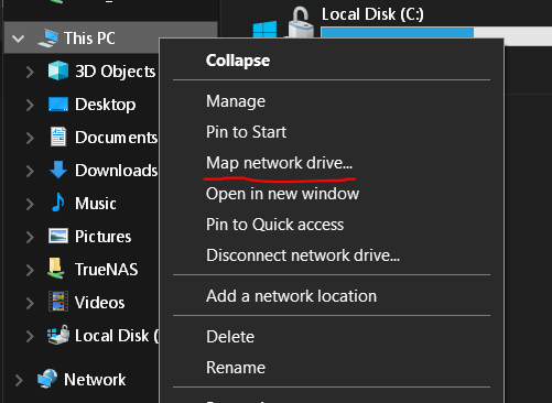

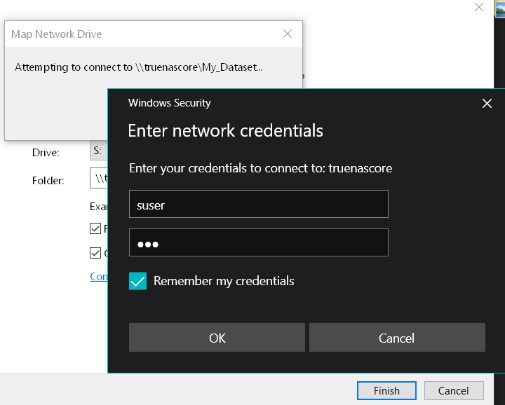

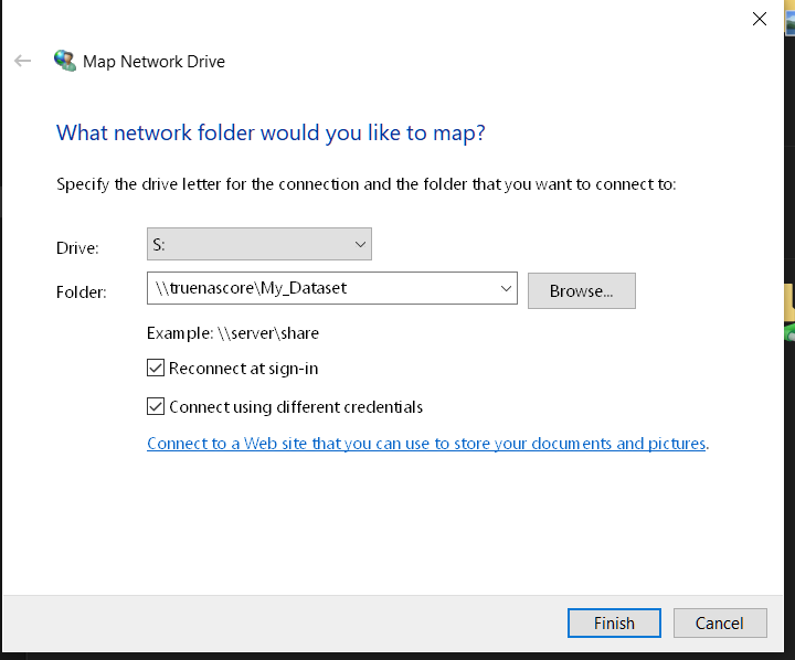

Now go to windows explorer, then right click on ThisPC -> map a network drive:
Then choose a Drive Letter and enter the location.
Be aware that your truenas system is simply called truenas instead of truenascore.
I just changed that because it would conflict with my real truenas.

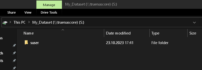

Also select "Connect using different credentials". Because the user we created in TrueNas is not your Windows User which windows will attempt to login by default.
After you flick finish Windows will as you to enter the credentials:
Do that , click OK et voila:
SMB up and running.

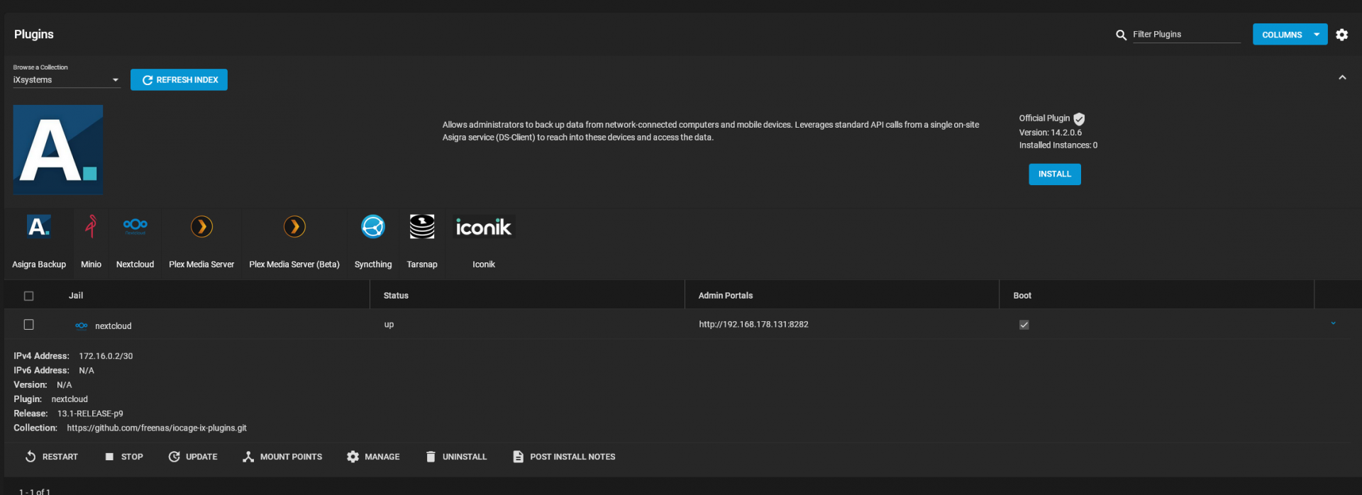

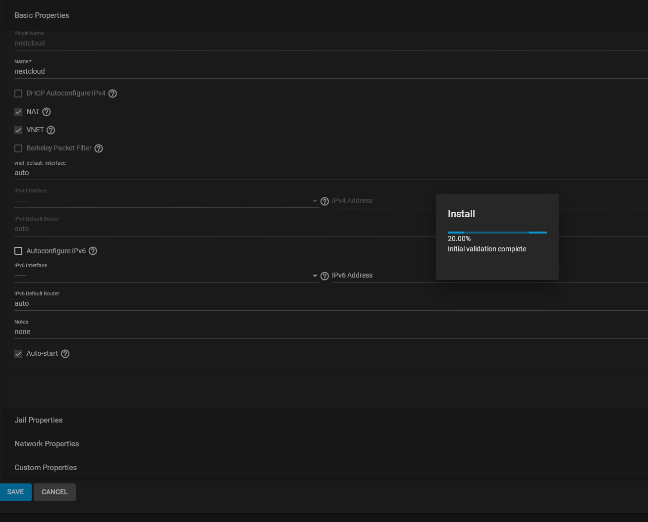

Go To Plugins -> NextCloud -> Install -> choose a name and click Save.
Nextcloud will install:
After the Installation it should show as "up".

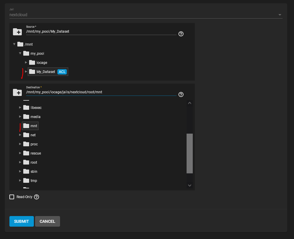

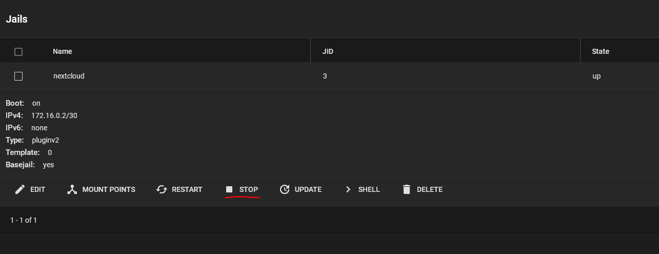

For this we need to stop nextcloud again:

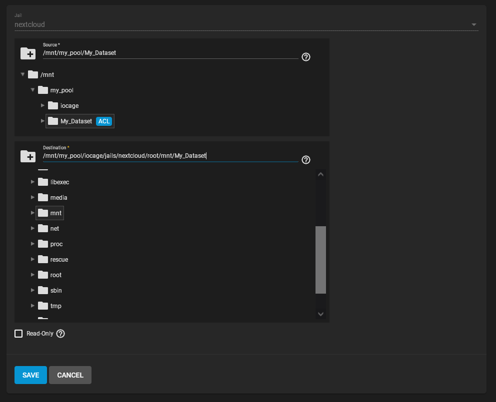

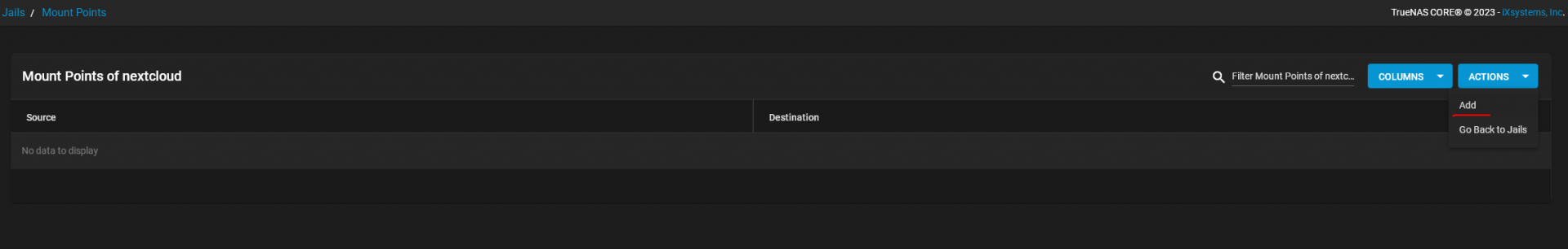

Then click on Mount Points:
Actions -> Add:
Choose the dataset to share (in my case My_Dataset) under source and "mnt/My_Dataset" under Destination as target (you have to enter the "/My_Dataset" manually:
This way it will mount under nextcloud. Hit submit.
Go back to Jails -> Nextcloud -> Start.

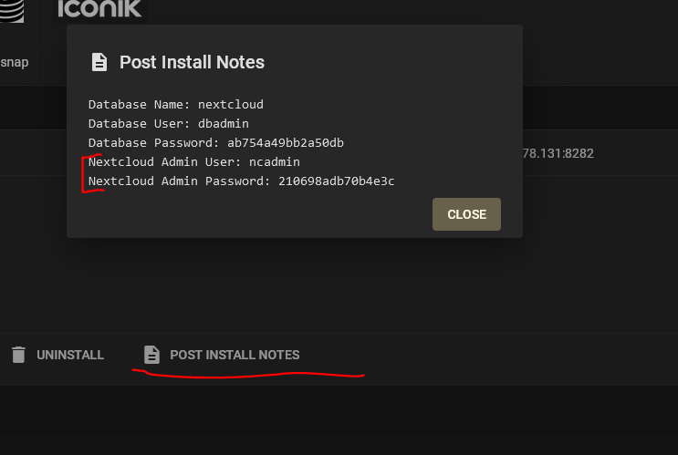

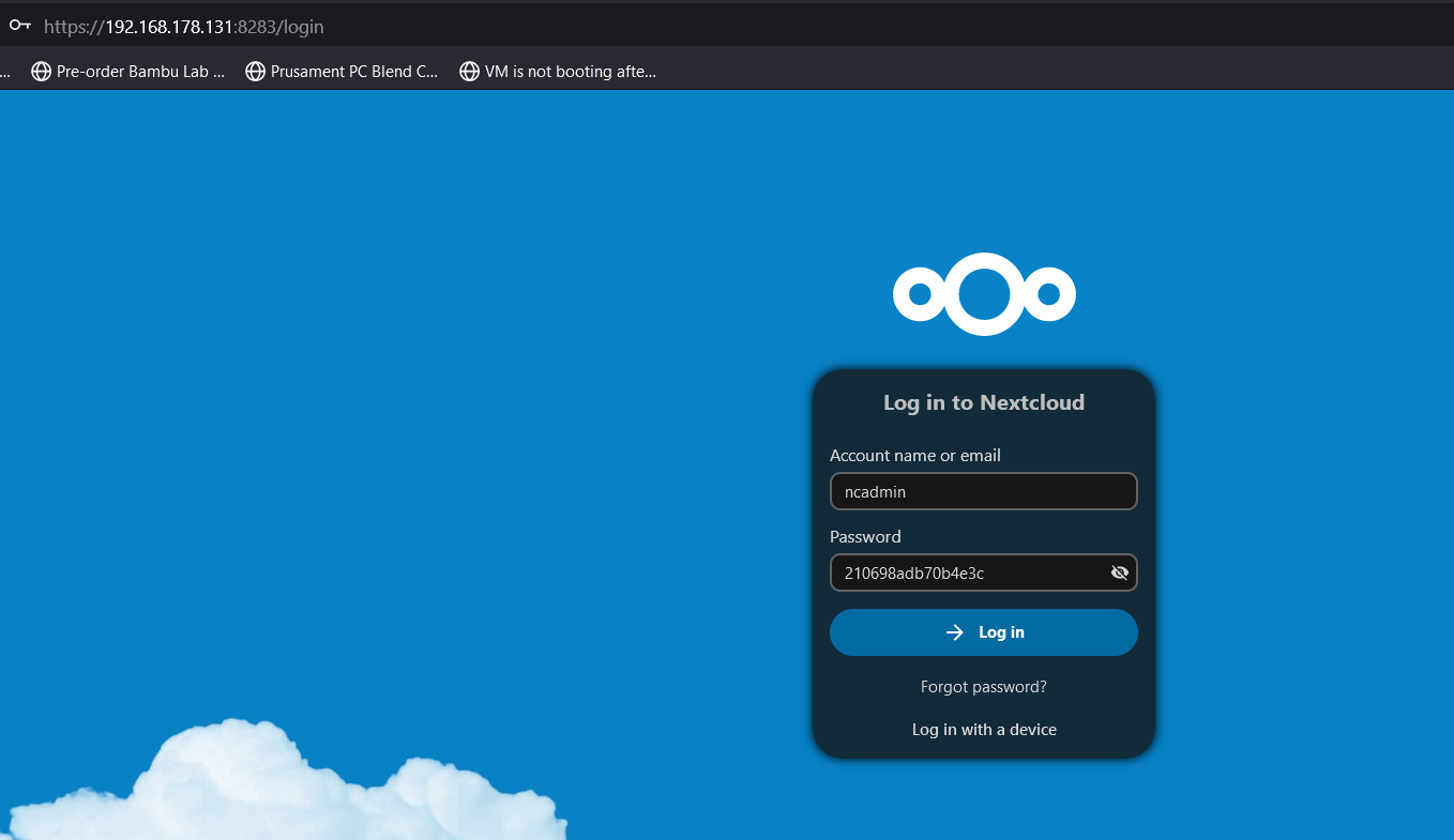

Wait for it to start up and copy the address for the admin portal:
and login with the credentials you find under "Post Install Notes":

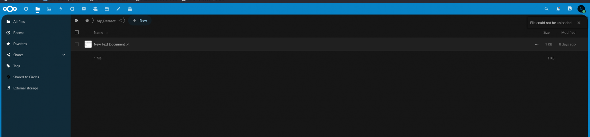

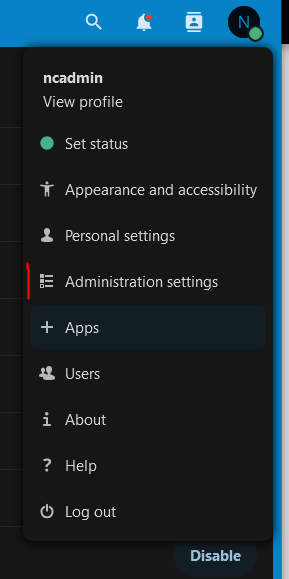

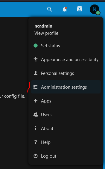

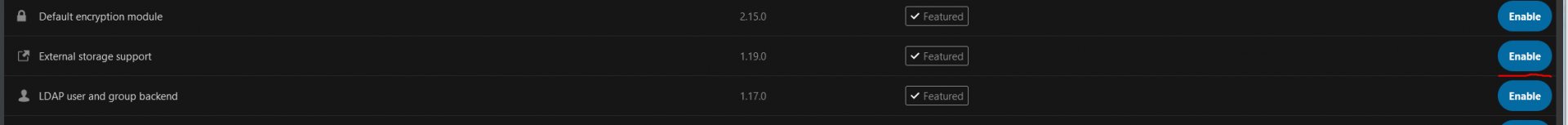

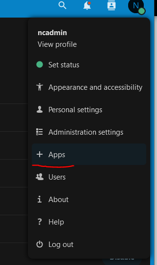

Now click on the "N" on the top right and choose Apps:
Scroll down until you find "External Storage support". Enable it:

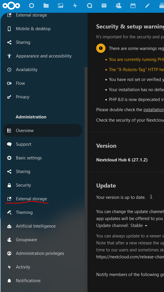

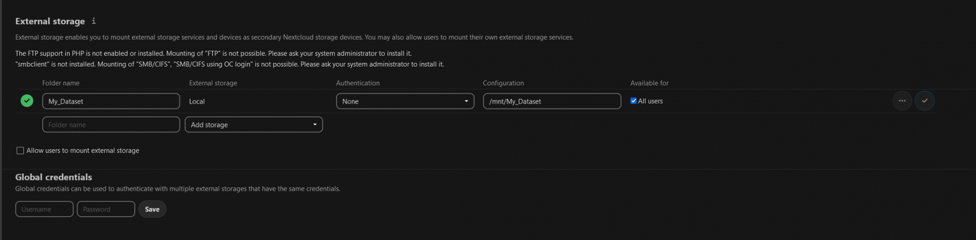

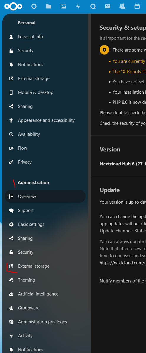

Now go to Administration settings:
and choose External storage (under the Administration section. Not under Personal!):
Here we enter the Folder Name that NextCloud should display to the users. E.g. TrueNAS_Storage or just the name of the dataset (which I used)
Then the Storage Method "Local" and the path to the storage "/mnt/My_Dataset" which we defined in the Mount Points. You can also select which NextCloud users may access the folder:
Click on the Check arrow on the right and the entry should be marked green on the left side. This means everything works and NextCloud can access the dataset/folder.
Now you can access the files stored under My_Dataset via SMB from your windows PC and also from within nextcloud.

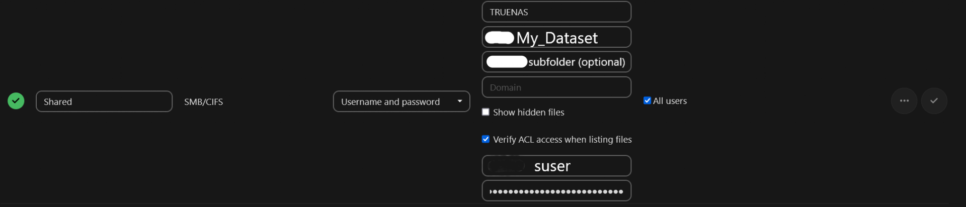

If you get SMB working then the only difference is how you set up external storage.
Instead of choosing local you choose SMB/CIFS.
Enter the credentials of a user who has access to the share (e.g. the user we defined at the start)
Enter TRUENAS for Host
My_Dataset for Share
and any specific subfolder or subdataset if you want to restrict access to that.
Actions -> Add:
It's quite late and there might be errors or practices which should be avoided.
If any of the more experienced users could point these out that'd be great :)
Sorry but it dosnt work.
i see the Space but nothing loadet in this folder up.
its only loadet in "sofortupload" folder
wen i want manualy upload a picture i dont can upload any media

Ah, Sry. Forgot to set permissions for Nextcloud. Because nextcloud is running under a systemuser called "www" that user needs permissions to access My_Dataset.
To do that we got to: Storage -> Pools -> My_Dataset -> Edit Permissions:
Scroll to the end of the list and click Add ACL Item:
Under Who* you select User
And in the User field you enter www. Permissions should be fine by default (Basic, Modify).
Check: Apply premissions recursively
And if you have more datasets below My_Dataset then also check apply permissions to child datasets:
Click Save and test if you can upload files. It should work now:
TiboTake
Apr 13, 2016
42
Perfect, this work... now i testing from my smartphone to upload

I found a little Bug...
All User can See the Folders from other Users and all the Uploads... thats not good
for multiple Users you need for every user on montingpoint

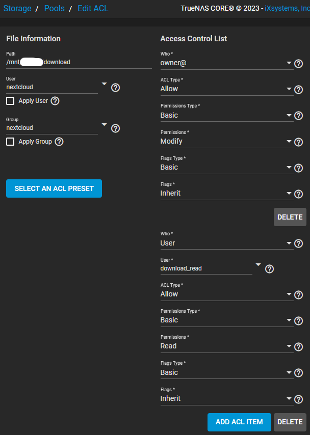

Ok, my bad @asap2go, I have misinterpreted your post. In TrueNAS, everything is named permissions: Unix permissions and ACL, and it's confusing.
You definitely use only ACL, which is what I was talking about in my precedent message.
So, to be clear, an example with Nextcloud in a Docker container (with Nextcloud in Jail, it would be www:www in place of nextcloud) :
And there is the user "download_read" to mount this share in Windows or something else, to not mess up the Unix permissions.
And for users home, this works great:
https://www.truenas.com/docs/core/coretutorials/sharing/smb/homeshare/
