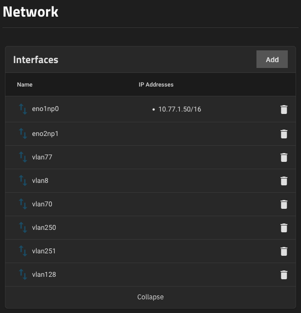

I definitely started using VMs on my system at some point during the window that mDNS "broke". I have a couple of docker apps running too, but those were already running when mDNS was still working.
In order to make the VMs behave the way I wanted them to, I definitely made changes to my networking configuration. Here's a snapshot of the configuration right now:

Here's my explanation:
I use managed switches and VLANs on my network to segment traffic into buckets for different purposes and for different levels of trust. My TrueNAS machine has two physical 10gbe interfaces:
  • Interface zero is set up as the "NAS / Management" interface, and the switch forces all of that traffic to be on a particular VLAN.
  • Interface one is connected to a trunk port, and it's allowed to send tagged traffic onto multiple VLANs.
Each virtual machine on my SCALE box is connected to a particular VLAN interface, which forces that VM to be on a particular VLAN. The advantage of this is that traffic between the VM and the NAS must travel through the firewall and be subject to inspection by Suricata. This is necessary because some of these virtual machines are actually exposed directly to the Internet via port forwarding.
Back to the NAS, ideally it should just be doing its thing on eno1np0? The macOS clients in question here are sitting on the same VLAN and (I have double-checked) none of that traffic is being inspected or filtered by the firewall because it never leaves the 10gbe switch.
If I did manage to break something with this network configuration, I'd be very interested if someone could recommend some troubleshooting steps I could try.
My hope is to find a working configuration that keeps TrueNAS traffic on interface zero and keeps all VM traffic (segmented by VLANs) on interface one.

You need to have a bridge for every VLAN for broadcast to work properly and assign the IP of the host to the bridge on that appropriate VLAN/NIC.
It should go like this:
Physical adapter -> LAGG (if you're doing that) -> VLAN (if you have VLANs) -> Bridge (IP address of host goes here if it will have an address on that VLAN).
Is that true even if I want to separate my NAS broadcast traffic from my VM traffic? I do not want TrueNAS to be broadcasting onto any interfaces except eno1np0.
Also, to be clear, I do see mDNS traffic coming across my macOS client. If there was a network configuration issue I would expect the number of mDNS packets to be zero.
I might look into shutting off all the VMs and deleting the extra network configuration as a test.
9,703
As soon as you have anything going on with VMs, you need to abstract your host's own connection from all the other connections by using a bridge (think of it as a Virtual switch).
That ensures that traffic from the host is clear and distinct (even to the host itself) from all the other traffic passing on the NIC.
By all means do the test you're talking about, but I imagine the solution will be the bridge (at very least on the host NIC, but maybe also on the ones carrying VMs)

Well, this is really interesting. If I stop all of my VMs and delete all of the supporting vlan* interfaces, mDNS starts working.
I tried building the Physical NIC -> VLAN -> Bridge structure for each VM, and mDNS broke again.
I'm going to walk through the whole setup again more slowly and see if I can isolate the specific configuration change that kills it.
alexmarkley
Jul 27, 2021
40
Okay, I think this is solved. Thank you @stretalla for providing the key clue to solving this issue.
TL;DR, my working network structure now looks like:
  • Physical NIC 0 (no IP)
    • Bridge 0 (br0) with host IP address.
  • Physical NIC 1 (no IP)
    • VLAN X (vlanX) (no IP)
    • VLAN Y (vlanY) (no IP)
    • VLAN Z (vlanZ) (no IP)
My VMs are attached to the various vlanXYZ interfaces with no additional bridge interfaces required. The host IP address needs to be assigned to br0 interface even though there are no other users of this interface.
I still do not understand why this the bridge interface is necessary. Technically you don't even need any VMs running to break things.
mDNS will break if I even just build this network configuration, even if I don't start any VMs:
