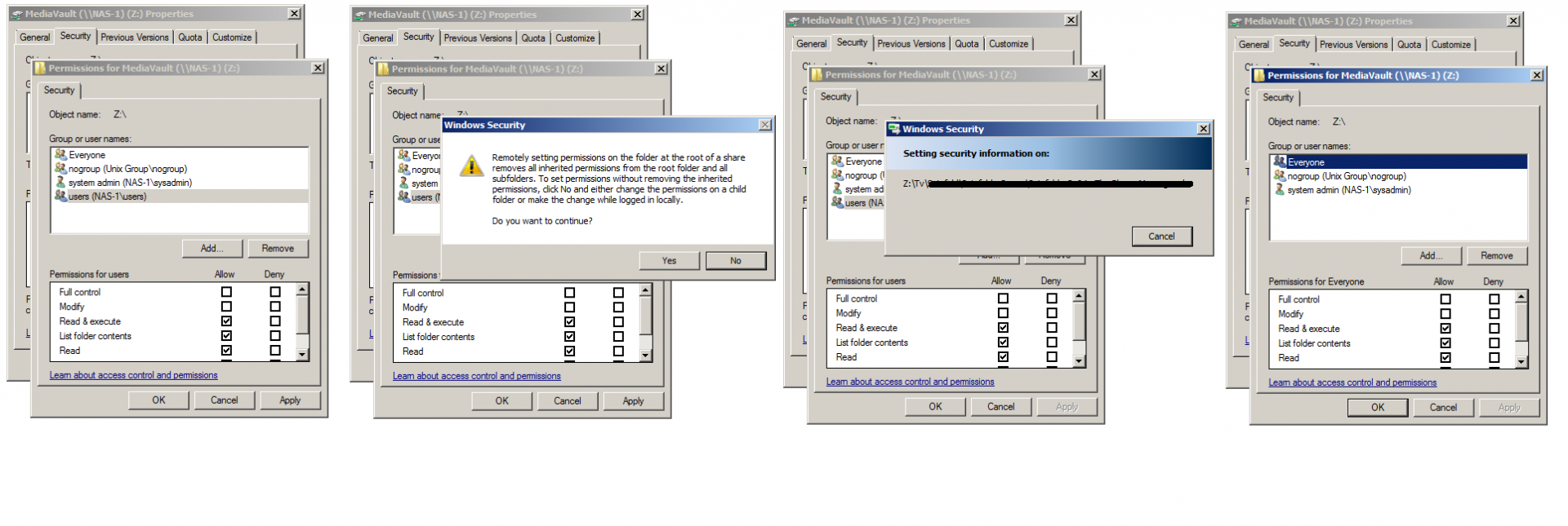

When I try to add the group from Windows, it adds it, then starts applying it recursively to files/folders, but then it disappears.

Refer to attachment.
'sysadmin' is the owner (user) and 'nogroup' is the owner (group) for dataset 'mediavault'.
I'm trying to add 'users' group to the share security from Windows.
anodos
Sambassador
Mar 6, 2014
9,553
Upload a debug file "system" -> "advanced" -> "save debug". If you're concerned about private data, send me it in a PM.
anodos
Sambassador
Mar 6, 2014
9,553
It looks like you're trying to set permissions for the well-known group "Users" in the Windows world. S-1-5-32-545 This isn't generated in the default FreeNAS group mapping. Try creating a group in the FreeNAS UI and then assigning permissions to it.
