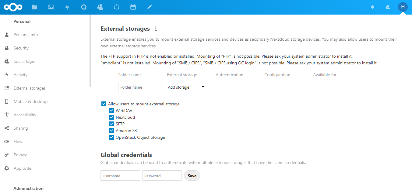

I'm trying to install smbclient to mount a couple of smb shares. Software details are at the bottom.
The FTP support in PHP is not enabled or installed. Mounting of "FTP" is not possible. Please ask your system administrator to install it.
"smbclient" is not installed. Mounting of "SMB / CIFS", "SMB / CIFS using OC login" is not possible. Please ask your system administrator to install it.

If I say yes, it removes a load of packages and Nextcloud stops working and if I say no, nothing installs. I'm running FreeNAS-11.3-U3.2 and Nextcloud plugin in a 11.3-RELEASE jail. Thanks.

Nothing strange here. When you install a part of the php72 installation it will deinstall php74.
Why are you trying to install the php72 version of smbclient?
If I do a search in my 11.3 jail:
pkg search smbclient
php72-pecl-smbclient-1.0.0_1   Smbclient wrapper extension
php73-pecl-smbclient-1.0.0_1   Smbclient wrapper extension
php74-pecl-smbclient-1.0.0_1   Smbclient wrapper extension
Please note, you are trying to install packages in plugin-jail. Your changes will probably be gone, when the plugin itself gets updated.
