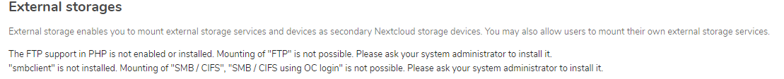

Hello, how do I enable SMBCLIENT through Freenas for Nextcloud. Not sure how to do and i haven't had to do much editing before to make it work. I'm working from a new install of Freenas & Nextcloud.

I have next cloud set up and working. My question is how do I enable SMBCLIENT for Nextcloud as it wasn't enabled/installed from the available plugins on Freenas

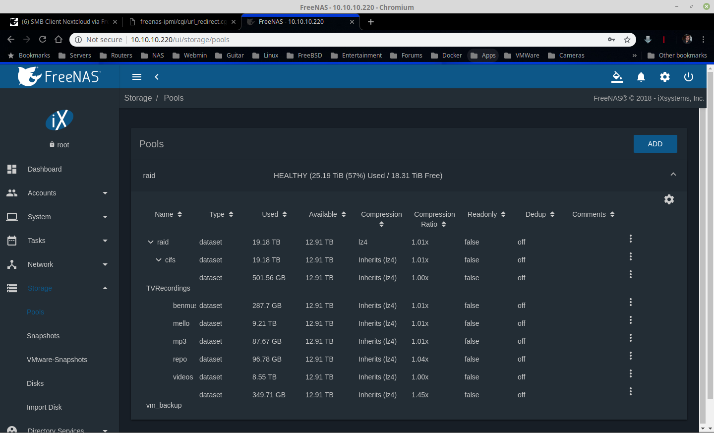

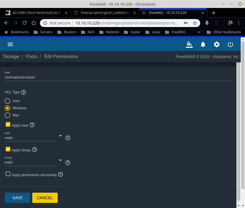

Storage > Pool on the left
Expand the volume until you see the directory you are storing the files and have added to the plugin
Click the three dots on the right of its name
Click Edit Permission
Check if Windows is selected
Check if the user and group are yours
Click Apply permissions recursevely
Click Save
Check your access

Thank you; in the end I set the user to Everybody, and No group for the group Unix. It's working both on the Share & Nextcloud.
