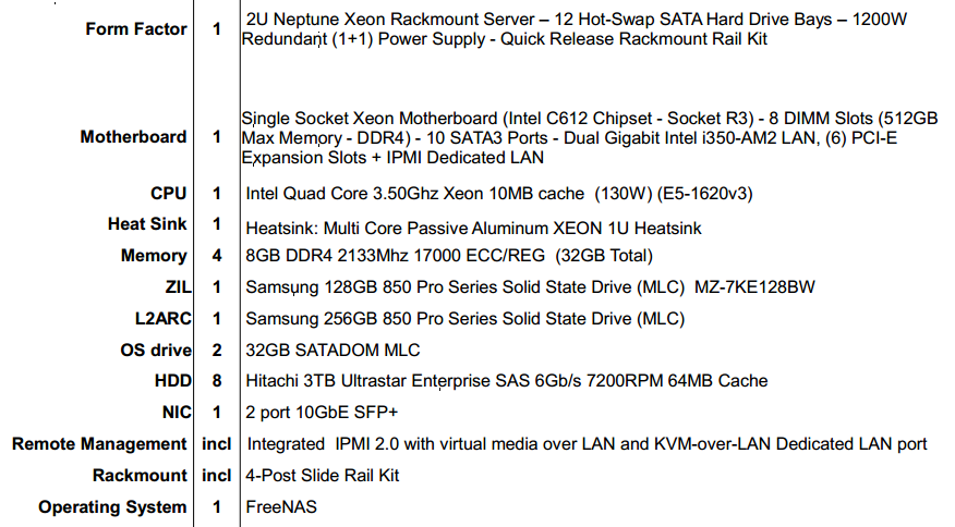

Thanks for your answers! The Neptune server was suggested and preconfigured by ixsystems with the Samsung SSD's.
This is the link to the neptune server info:
https://www.ixsystems.com/servers/family/?family=Neptune 2100&&server=2112
This is the complete config :
I agree that setting sync=disabled is bad practice. What I am not understanding is that (with sync=standard) we get such bad write performance, while having an SSD as slog. @Mlovelace : Maybe the Samsung 850 is not optimal as an slog, but does this explain this bad performance? Write performance should be better, right? You are right however on the dd-test. I did not disable compression.

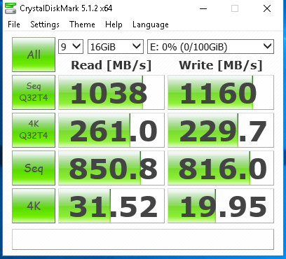

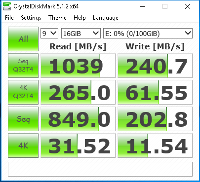

I understand that there is a powerloss safety issue with the samsung SSD. Do you however think my write performance of 15MB/s would go up to > 100MB/s by swapping it with an Intel 750 SSD?
This is a test I ran with sync=always using the Intel DC S3700 as a slog on a NFS share.
As you can see I am maxing out the write capabilities of the S3700, and being that the 750 is a much faster drive, I would hazard a guess that it would preform better.
Same test with sync=disable on the same NFS share.

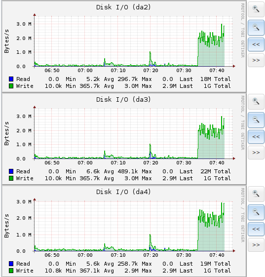

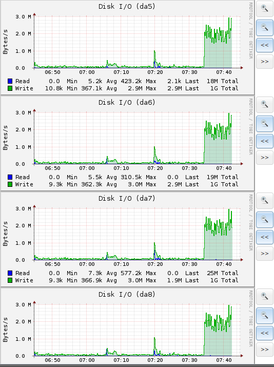

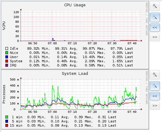

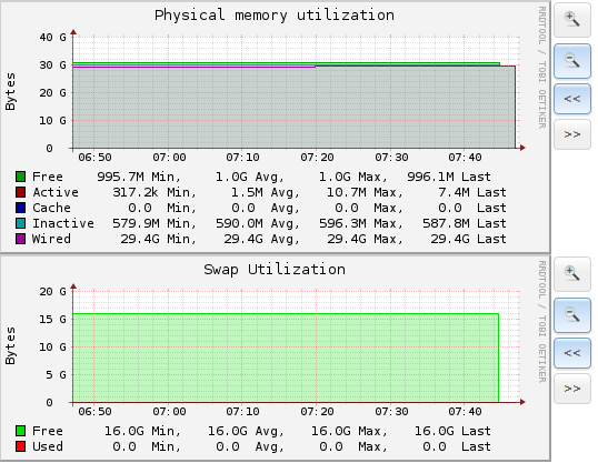

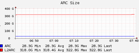

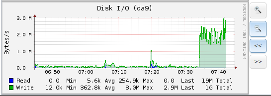

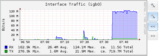

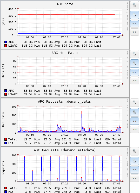

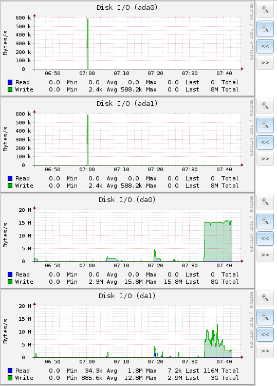

See below some graphs. I hope that they will bring some answers :
Thomas.

Migration is going at 7.8MB/s.
during migration I've set sync back to disabled and migration speed went up to 54MB/s.
So the syncing is for sure the bottleneck.
