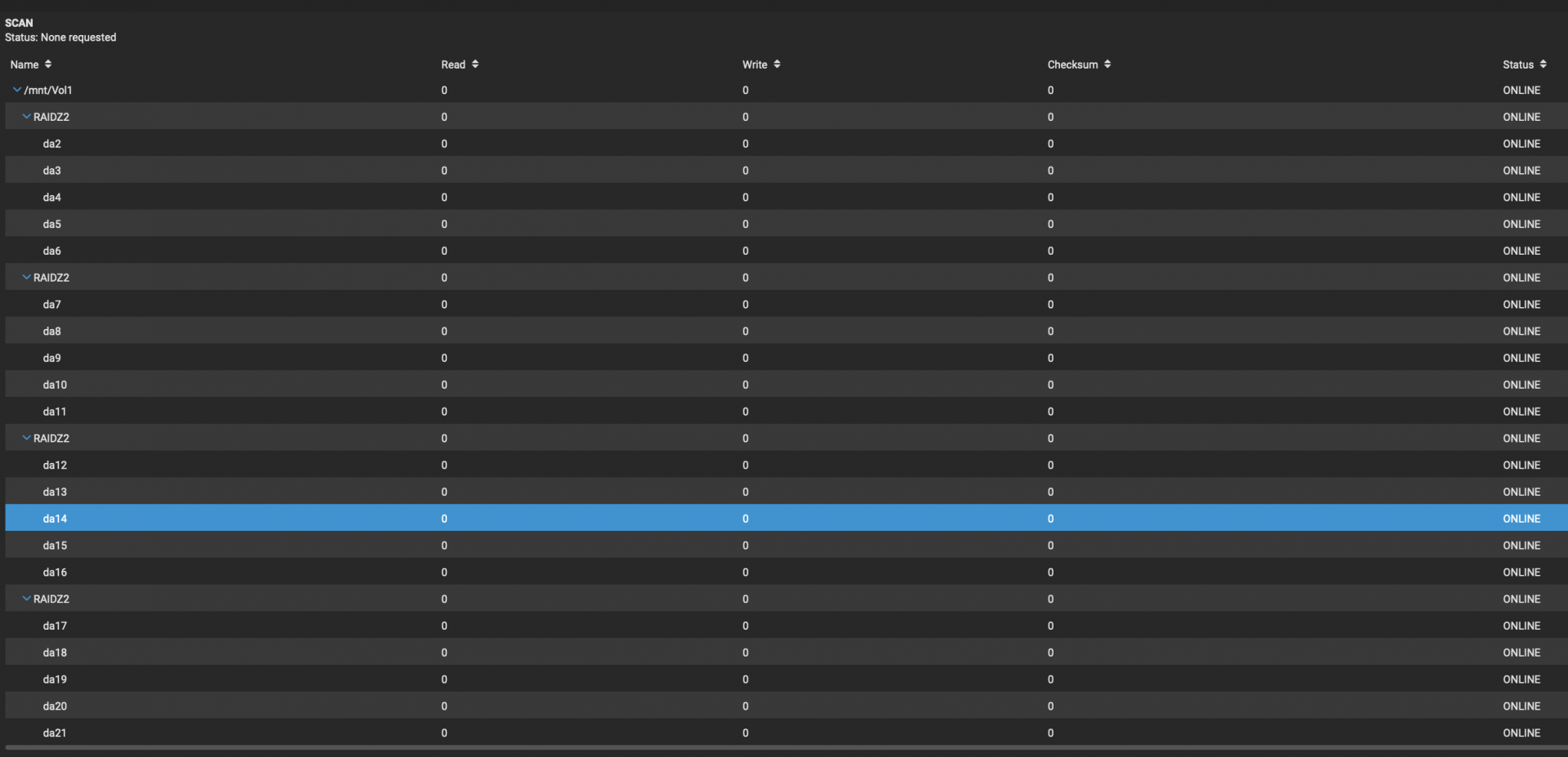

So, I installed TrueNAS with the controller set to HBA mode
Getting 133MiB/s write and 226MiB/s read; I had to disable SYNC for these speeds
Is this acceptable for 10k rpm drives?
Testing what which way?
icepicknz
Feb 11, 2023
19
On the TrueNAS writing and reading direct to the volume

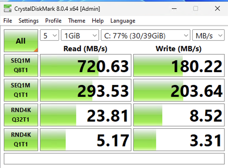

So spun up a windows VM (Haven't used windows since XP!) and it took ages to install, suspected slow disk.
This says it all.
