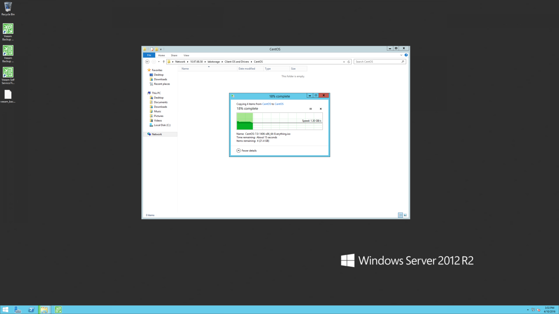

I disagree, I think CIFS will crap out at some point well below even what two striped SATA SSD's can deliver. One of those things where I'd like to be proven wrong.
Mlovelace
Aug 19, 2014
1,111
CIFS definitely has overhead but you can saturate a 10Gbe network with it. NFS would be a better way to go given the filer's current specs.
Edit: I'll just go back to breaking my own stuff :)

Mlovelace
Aug 19, 2014
1,111
*coughs something that sounds suspiciously like "put up or shut up"* :p
This is the best I could do from home. CIFS transfer to the filer in my signature from a Windows 2012 r2 server. That is full line rate 10Gbe over CIFS to freeNAS 9.10
