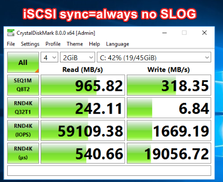

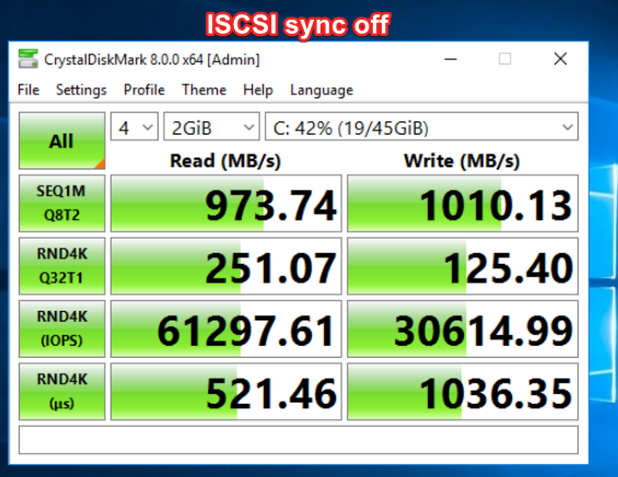

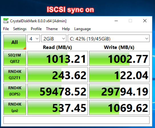

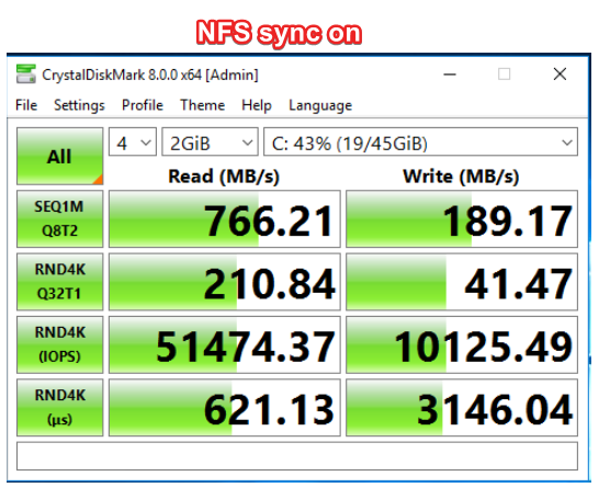

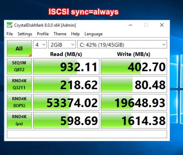

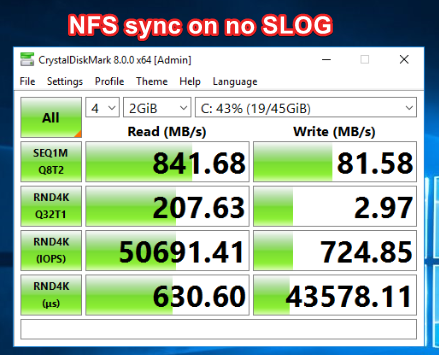

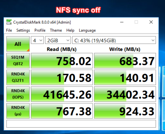

douglasg14b
Nov 26, 2017
26
So... I have SLOG device, a 400GB Intel DC S3710. I get very slow writes with NFS. If I disable sync. the writes are quite fast again.
Having a SLOG device didn't seem to help a whole lot with NFS, is there some other solution other than disabling sync?
Below are screenshots of some perf tests. The ISCSI ones are meant to be a baseline, indicating that this is not a networking or a disk issue. This is a pool of 5x SATA3 SSDs in RADZ1.
I'd expect to get ~300MB/s with NFS, rather than 189MB/s.
Yorick
Nov 4, 2018
1,912
