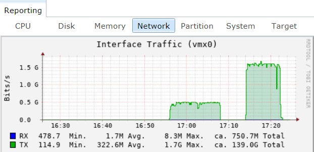

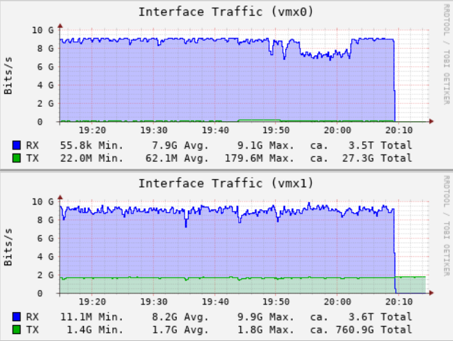

Sorry for the delayed reply, but many thanks for your kind offer to assist by way of suggesting VMXNET3 could be the issue. :) Honestly, you caught me be surprise with your comment as I've used the VMXNET3 adapter since initially following a guide to virtualize FreeNAS back in Apr '17 and haven't had any issues to speak of. I did reference the guide and man page as suggested, however, due to the lack of chatter with more recent FN versions regarding the adapter + other trouble shooting, I've decided this can be ruled out as a culprit.
If I understand correctly WCPU is weighted, so sshd @ ~90% doesn't necessarily mean that CPU is maxxed out, right? I remain at a loss to explain current ~250 MB/s replication speeds over a 40G link, but if pinned down for a guess I would begrudgingly suggest that my bottleneck is single threaded SSH and a E5-2690v2 @ 3.0 Ghz and E5-2680 v2 @ 2.8 Ghz can only offer ~250 MB/s via replication. While I lack the experience / accumen of many on this forum, those are rather beefy processors, even though a few generations old, so my uncalibrated opinion is that I'd be surprised if that was all they could handle.
Note, I've included the output of top and zpool iostat to help support my above comments (presented in code tags embedded in spoilers below).
Any thoughts for further troubleshooting (this is driving me nuts)? Other than the fact that FreeNAS is virtualized, I'd suggest that I'm nearly precisely aligned with what is commonly accepted as FreeNAS "best practices" down to 512GB of ECC RAM (as one example).
Is it possible this is a bug and I should log it (I've never done so before and don't want to waste anyone's time)?
As always thanks for your assistance and I hope that you and your family are enjoying the holidays.

I do use replication tasks for most of my file syncing chores... But sometimes rsync is handy.
I'm running an rsync test right now with the schema I post earlier. Sad to report that I'm only getting ~500Mb/s over my 10G network. :confused:
When that completes, I'll scrape away the test target data and try a replication job. We'll see if that runs any faster. I'll post results later on.
  • Got it - thanks for clarifying.
  • Jumbo frames??? :oops: (kidding - I'm sure you recall my epicly bad sense of humor)
  • I'd take 500 MB/s any day of the week and twice on Sunday compared to current.

That's a lower-case 'b', so I'm only getting 500 mega-bits per second. I'd be jumping with joy if it was mega-bytes instead! :D
Turns out that replication runs about three times faster than rsync on my system; 1.5Gb/s vs 500Mb/s. Nowhere near the capacity of my network, but better that 1G Ethernet!
  • Sorry let me correct that ...
  • zfs set casesensitivity=sensitive svtkobra7
  • replication > rsync doesn't surprise me given prior experience (thanks for the follow up).
  • So we are in the same neighborhood in regards to snapshot replication speed, which may actually support the ssh CPU bound theory I dislike.
    • Was Bacon pushing (2.8GHz)? As I have a 2.8GHz processor pushing as well. And if you look at max throughput, it is 1.8G in my case and 1.7G in yours. But likely I'm looking to connect dots that aren't to be connected.
  • Do you have any theories, even if working, unsupported as to what is going on here?
In my case, clearly it isn't the network (as is well established) as FreeNAS has been pushing nearly 20G for the past hour ...
  • rx = iperf (vmx0 = 10G switched / vmx1 = 40G direct)
  • tx = snapshot replication, which interestingly isn't hindered noticeably with all of that traffic.
I do not have any theories as to why replication and rsync are both so slow compared to the 10G network infrastructure. I get iperf test results at near line rates -- greater than 9Gb/s between my two 10G systems, 'bandit' and 'boomer' -- but this isn't reflected in real-world performance.
That's why I've been watching your post. I'm hoping that someone more knowledgeable will come along and set us both straight. ;)
