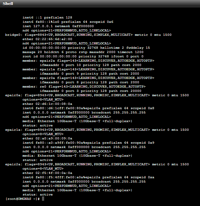

Since I upgraded to 9.1, my LAN transfer speeds have dropped from around 70-80Mb/s to around 10-15Mb/s (I also installed Plex since then, and doubled my RAM from 8GB to 16GB). I'm still using the same hardware (aside from doubling the RAM), and ifconfig reports all of my network connections as either 1000baseT or 10Gbase-T (full duplex). Also, iperf run between my NAS and the machine I usually FTP through reported that the connection timed out. For the record, I'm using Filezilla as my FTP client, on port 21 (which has also been allowed through Windows firewall).
I have included screenshots of my ifconfig and iperf results. Any ideas as to what's going on?

No, all of your network connections might not be 1000baseT or 10Gbase-T. Your epairs are(duh.. they're virtual network ports), but your actual ethernet port is not listed. The ports I want to see are off the top of the shot. Whoops. :P
Also, not sure what your iperf was trying to test, but I believe that you tried to test the speed from your nic to the same nic. Not surprisingly, you got more than 1Gb/sec.
And you didn't include the rest of your hardware.
But it looks to me like you really didn't convince me you have no network problems because there's no useful data from the iperf or ifconfig shots. ;)

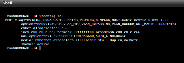

Alright, just ran ifconfig for re0 (the physical NIC). Here are the results. Also, am I doing iperf right? Seems like, since I can definitely connect via FTP, they're able to communicate. Not sure why it should be timing out. The hardware NIC is an integrated 10/100/1000Gb on the mobo, connected with Cat6 (in fact, the entire house should be at Gb speeds). I'm not sure what other hardware specs are relevant, so let me know what else you need. Thanks again.
ETA: Still getting "timed out" errors using iperf. 200.20.2.200 is the machine I usually FTP from. If I get any results at all, it says timed out. I've tried this a few times now, and mostly it just hangs for a long time, sometimes producing the aforementioned result.
