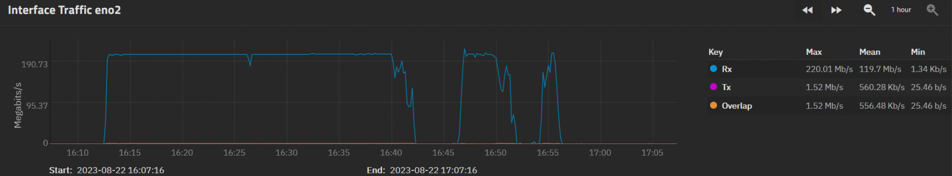

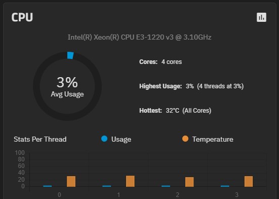

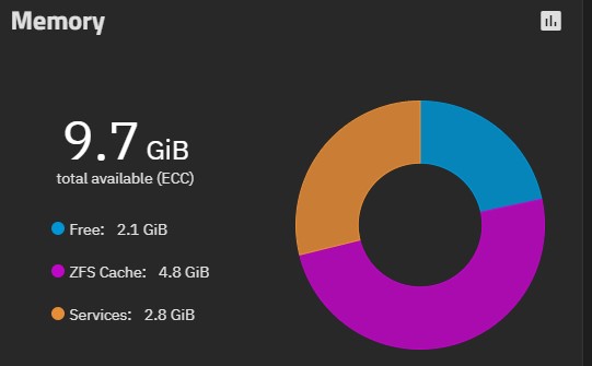

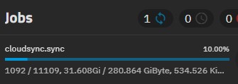

Hi All,
I'm running TrueNAS-SCALE-22.12.3.3 on the system in my signature. Performing a cloudsync pull of about 500GB from a Onedrive for business account to the TNS system over a 300Mbps internet connection, and I'm about 4 hours in and have only transferred about 80GB of data. The sync configuration has bandwidth limited to 25MB and the sync starts out strong, but then the transfer speed drops to bytes/sec, with the odd shortlived burst back up to 25ish MBps.
I've tried different NIC cards (all intel), different routers(pfsense & asus consumer), even different mobo/Cpu combos for the Truenas system (Asus Z690 Pro w/ i5-13500), but get the same result. The addition of a LOG VDEV to the pool seemed to help keep the transfer speed up a little longer after starting the task, but then it drops again. CPU is sitting at 1% and half the memory is free.
The dataset being written to has the following settings: Sync=standard, LZ4 compression, Atime off, ZFS Dedup off, and the pool is encrypted. The data is all smaller files.
Can anyone point me in the right direction to get these speeds up, or what could be the bottleneck? Transferring about 3GB/hour will take days..

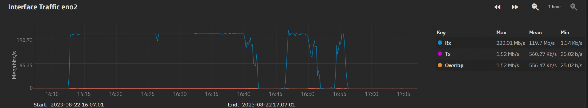

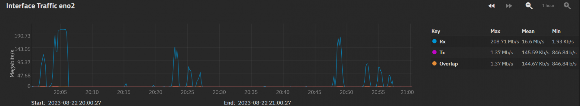

Started transfer at 16:12, ran flawlessly for about half an hour then..
this.

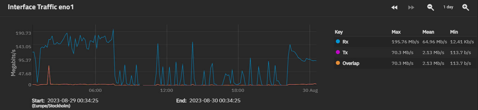

I'm having the same problem syncing my personal OneDrive to my TrueNAS-SCALE-22.12.3.3.I have a 250/250 internet connection and it starts good and maxing the line as I want to get it down fast (i have set it to "High bandwidth (16)" under the cloud sync settings) but then goes down to very slow speeds for some time and then up again and down again. I have my Synology NAS set to sync my OneDrive space and it run full speed untill it's done.
I have tested to stop the sync and and run it again but it just starts with good spped and then goes down again to almost nothing and then up and down.
Webo
Aug 29, 2023
6

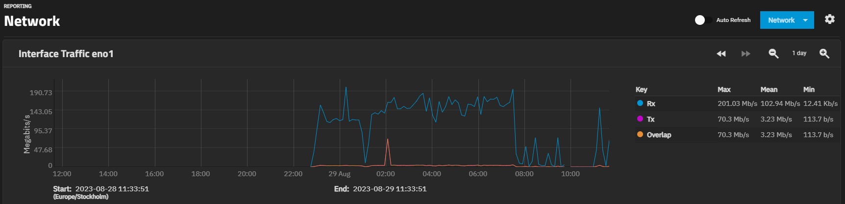

This is how it look last few hours

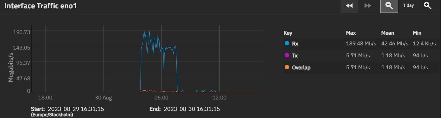

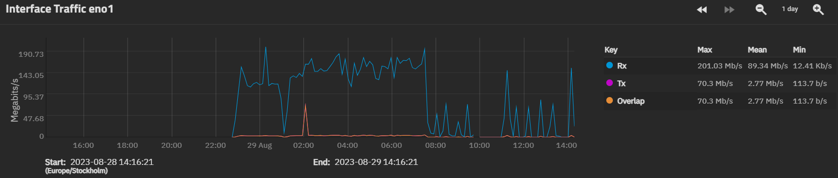

This is how it looks right now and during the day

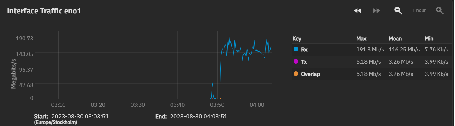

I had some strange time offsets. Dashboard said 2,5 hours ahead of time, reporting was right time and TrueNAS shell has 2 hours ahead of time. Searched for it and tried to solve it with the solutions I found but no luck so I thought I might as well change the boot drive anyway even if the speed was good. WOrked doe 1,5 hours to fit in a 2,5" SSD in the 3.5" hotswap cage and the plate I had made the connection ports sit to high so could not insert the disk but managed to get it working without a plate to fasten the SSD drive in as I screw it in the frame of the cage and then had som fiddling to get it to go into the connectors. I had saved the config before I turn it of and just did a reinstall och TrueNAS Scale again and when in I restored the config and it rebooted. After that my time is correct in Dashboard, Reporting and TrueNAS shell and so far it's running fast.
I'll see if it continiues all night as I'll get to bed and get 2,5 hours sleep before work starts :smile:
I'll update in bout 3-4 hours with info on hos it's going with the speed.
Webo
Aug 29, 2023
6
It went ok and it has now synced all files
So save config and reinstall and import config seems to have solved all my problems (3 different times showing in TrueNAS Scale depending where I look) and also the Cloud Sync. So maybe you can try the same and see if that solve your problem also?
