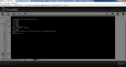

Hi all,
Im a newb to Freenas8 and scripts but have been using Freenas 7 for a few years.
Last month I lost a 1TB disk from my RAID1 so decided it was a good time to upgrade to Freenas 8.2.0. I am using an old machine to do some testing which is going well and I think I will be using this in production as it has a few more HD bays. Problem is this machine is noisier and consumes more power.
I stumbled across this thread and seems EXACTLY what i need however I just cannot get the script to work !!! Its probably me.......
So I have copied the code and saved it in my datastore (mnt/DataTest) but when I try to test from shell I get the below (and attached) error:
[root@freenas ~]# sh /mnt/DataTest/shutdown.sh
: not found
: not found
: not found
: not found
: not found
: not found
sec between polls: 30
Count In Delta Out Delta
: not found
: not found
/mnt/DataTest/shutdown.sh: 48: Syntax error: end of file unexpected (expecting "
then")
[root@freenas ~]#

Milhouse
Jun 1, 2011
564
Have you created the file in Windows format? Make sure you have created the file with Linux line endings.
Get the free version of an editor like TextPad that will allow you to open and save files with Linux (or Windows, or Mac) line endings.
