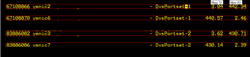

If I take this a step further and use a VM running on this zPool connected via iSCSI to FreeNAS using round robin <multipath IO> load balancing between 2, 1 Gb NICs I am getting about 103 MB/s write and up to 140 MB/s read. Doesn't seem to be consistent with the local FreeNAS results. And no where near the 1.92 Gb the drives should* be capable of. That isn't even considering their cache ability to burst.
When I attempt to perform a "storage vMotion" job between a "different" storage device and this FreeNAS box, take a look at the throughput metrics on the NIC links.
This output is reading from other storage device and writing to FreeNAS.
As you can see from the screenshot vmnic2 and vmnic3 are receiving just over 860 Mbps (RX) from the "other" storage device and writing (TX) it to the FreeNAS storage device using vmnic6 and vmnic7. Two completely separate 2 Gb links for each storage device perfectly load balanced. Only, each link is performing at about half of what it can...

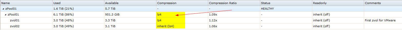

You need to turn off compression on the dataset you're writing on for the numbers to be meaningful.
Adam Tyler
Oct 19, 2015
67
Interesting. You'd think having compression enabled would slow things down.
You are saying that lz4 needs to be turned off here?
Here are the results after disabling lz4 on the dataset:
