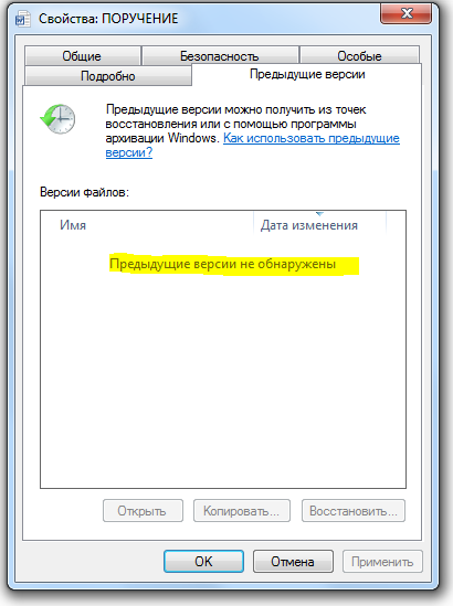

I have task do snapshot every 1 hour, but I don't see shadow copies :(

Having reviewed your config in the bug report, I noticed the following:
1) You are performing a recursive snapshot of /mnt/Public
2) Your shares are located under /mnt/Public/share/*
Try setting a non-recursive snapshot task for the dataset "Public/share/reports", then in your share config for [Отчеты] set the "Periodic Snapshot Task" to the new snapshot task that you created. Once it generates a new snapshot, check for it in "previous versions".
I think it'd be good to get one more datapoint. If you navigate to "\\fileserver", and right-click on your share(s), are you able to see previous versions?
On a side-note, it looks like your controlling access to your shares via "hosts allow" and using guest authentication. It may be a good idea to properly set ACLs on your shares (through the security tab in Windows File Explorer) and eschew the whole "hosts allow" thing.

1. I have made new snapshot task.
2. I set task in CIFS options for folder
3. I don't see shadow copies in Explorer

@dlavigne, I switched the UI to Russian, created a share with a cyrillic name, and created a snapshot task. The snapshot showed up in "previous versions". I do not think it is a localization problem.

I'm sorry, it was my mistake, my wrong understanding. All works fine.
Please, close topic and bug.
