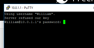

Hello!
Hopefully I'm just missing something simple, but I'm out of ideas and search results...
Screenshot of error:
Using PuTTYGen, I created my keys...
Put my Public key into my FreeNAS account (Through the GUI)...
Checked that the dataset that my user homes are in are using UNIX permissions...
Checked that the permissions of the .ssh directory and authorized_keys file were correct (from what I've read)
Anything else I might be missing?
Thank you in advance!

Trying three times (just to make it noticable) today, nothing is output to the log using "tail -f /var/log/messages" as described in the Documentation.
Also nothing found in /var/log/auth.log either:

What's the output of the putty event log ?
And can you double check the public key is assigned to the user William (as opposed to the Freenas account - which would be root // may be a misunderstanding on my part).
I used ssh-keygen for mine, but had no issues with putty once I copied the private key over.

=~=~=~=~=~=~=~=~=~=~=~= PuTTY log 2019.02.14 12:28:42 =~=~=~=~=~=~=~=~=~=~=~=
Event Log: Writing new session log (SSH packets mode) to file: C:\Users\William Miceli\Desktop\putty_ssh-packets.log
Event Log: Connecting to 10.0.1.1 port 22
Event Log: We claim version: SSH-2.0-PuTTY_Release_0.70
Event Log: Server version: SSH-2.0-OpenSSH_7.5-hpn14v5
Event Log: Using SSH protocol version 2

Event Log: Server refused our key
I copied the public key into my "William" FreeNAS account, and it is within my own user's home directory. I'm not sure how else to check otherwise.
William Miceli
Jan 24, 2018
18
Got it working...
Apparently copying what is output from putty-gen from the OpenSSH public key (which is slightly different than what it shows in the preview window) is insufficient.
Copying from the preview window instead makes it work...
Thank you for your help though @dknm !
