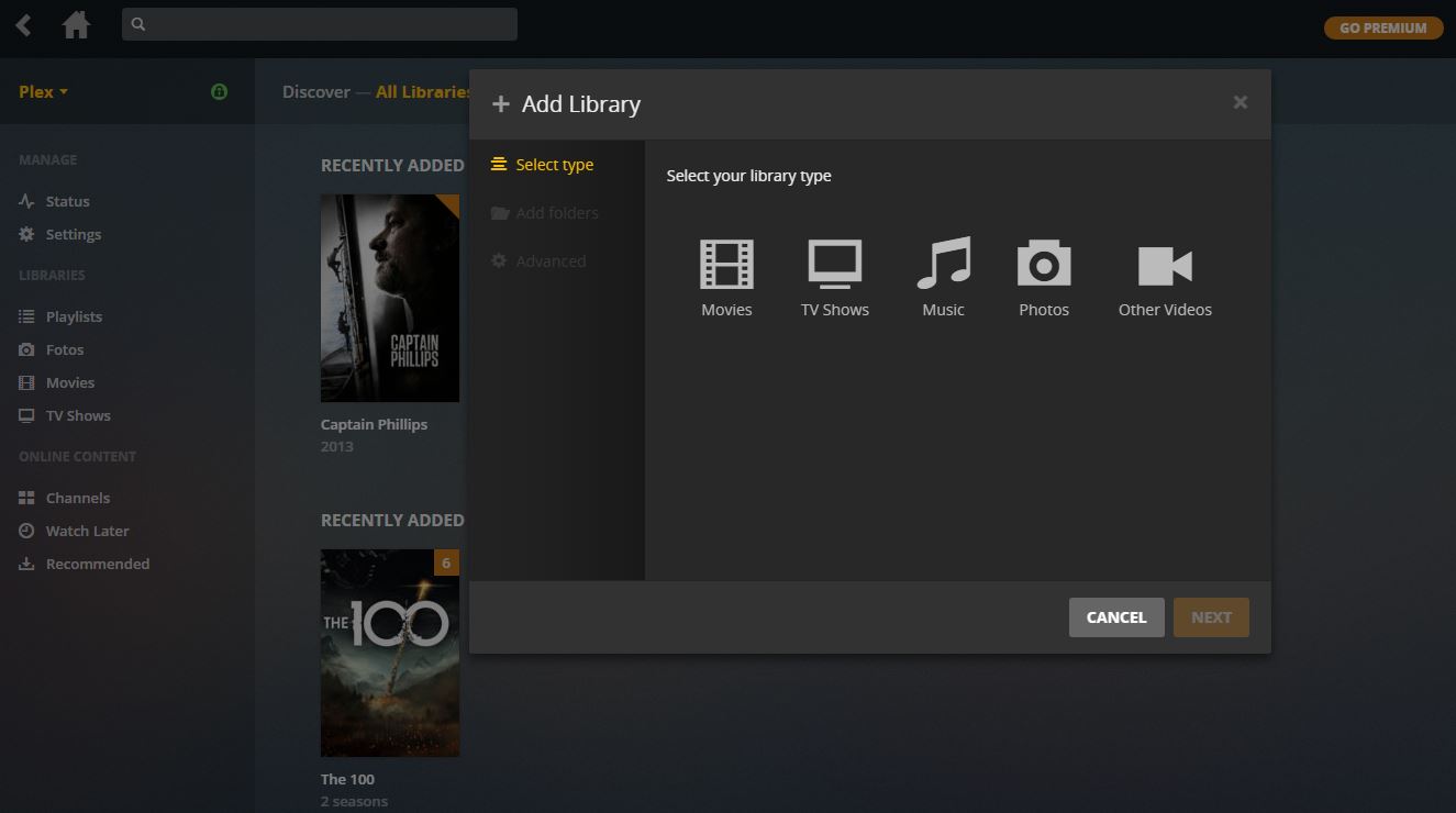

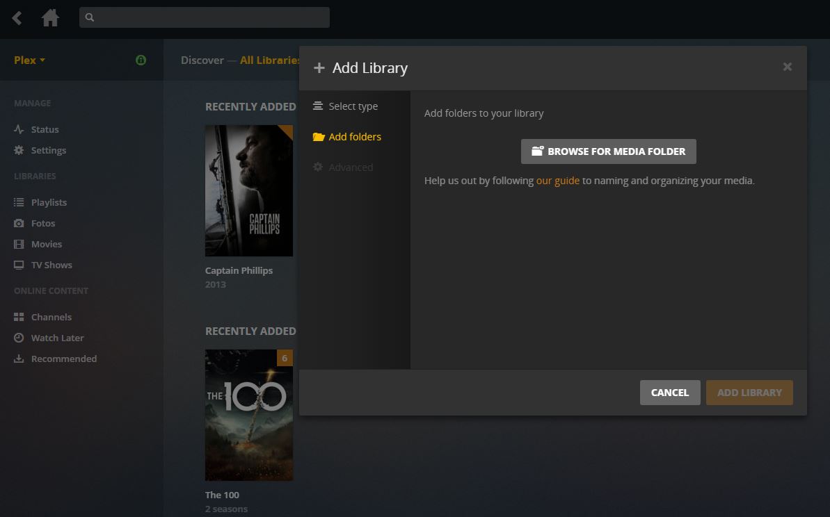

I have a server already up and running, but I'm wanting to create a new one more updated.
Now I have the:
FreeNAS-11.0-U3 (c5dcf4416)
Plexmediaserver 1.8.4.4249

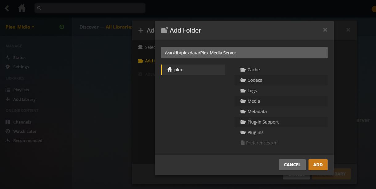

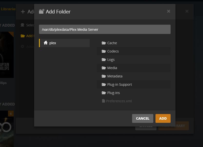

After installation is setup, when accessing the Media Plex, Add movie library, browse media folder, it opens a window with the following folder is not able to change:
/ var / db / plexdata / Plex Media Server, I have already changed the jails, but everytime in plex comes with this address, so I can not add the folder with the movies. First image.
Anyone have any idea what the problem is.

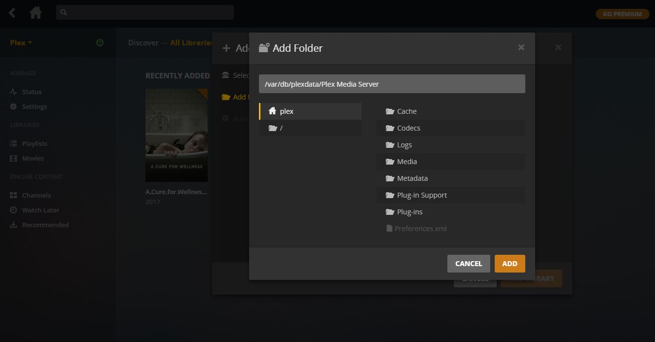

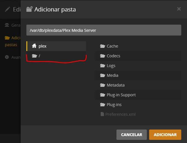

I installed the older version of Freenas, FreeNAS-9.10.2-U3 (e1497f269), in this case after installing the Media Plex plugin, the directory choice screen changed and I was able to add the movies folder, follow the second image.
Any way would like to install the latest version FreeNas.

Yes, but the path can be typed and saved, but it is not recognized, as if it were not typed.
LLeo
Jun 3, 2017
28
mOnkey says it correctly. Earlier Freenas/Plex installations acted correctly on "Add Folder." NOW(!) each time you do so, "/media/foldername" must be inserted which indicates the ACTUAL path in your "/mnt/YourFreenasVolumeName/jails/plexmediaserver_1/media/foldername". It is a little more inconvenient but no one has "fixed" it back to the "old" way. Those folders, however, are contained in the jail directory like they were before this surfaced as opposed to the /var in the root directory.

But the problem is inside Freenas with version 11, there is no way to change the path of the folders inside the plax, in installation 9.10, this option appears in the image.
Pancackewaffle
Aug 19, 2017
41
But in the area that says /var/db/plexdata/Plex Media Server, click there and you can enter manually

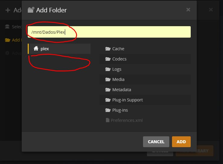

Thanks for the help, ok by clicking on it allows you to enter the path, save the path you typed but not it file in these folder, as if you ignore the path you typed.
SweetAndLow
Sweet'NASty
Nov 6, 2013
6,421
What do you mean when you say ignored the oath? I ask because we know it works by typing in your path, that is what everyone has to do in freenas 11.

At this point I did a new test, I installed the 9.10 version, I configured everything is was working, in the Freenas have the option to Update, I made the 11 Stable option, the folders that were previously working continues Ok, but when creating new folder to add as for example Photo library, no longer think, the same camanhino typed.
SweetAndLow
Sweet'NASty
Nov 6, 2013
6,421
It works.
You just need to describe what you are doing so we can point out the missing step. People can't magically know what you are doing. You have to explain it and probably give screenshots.

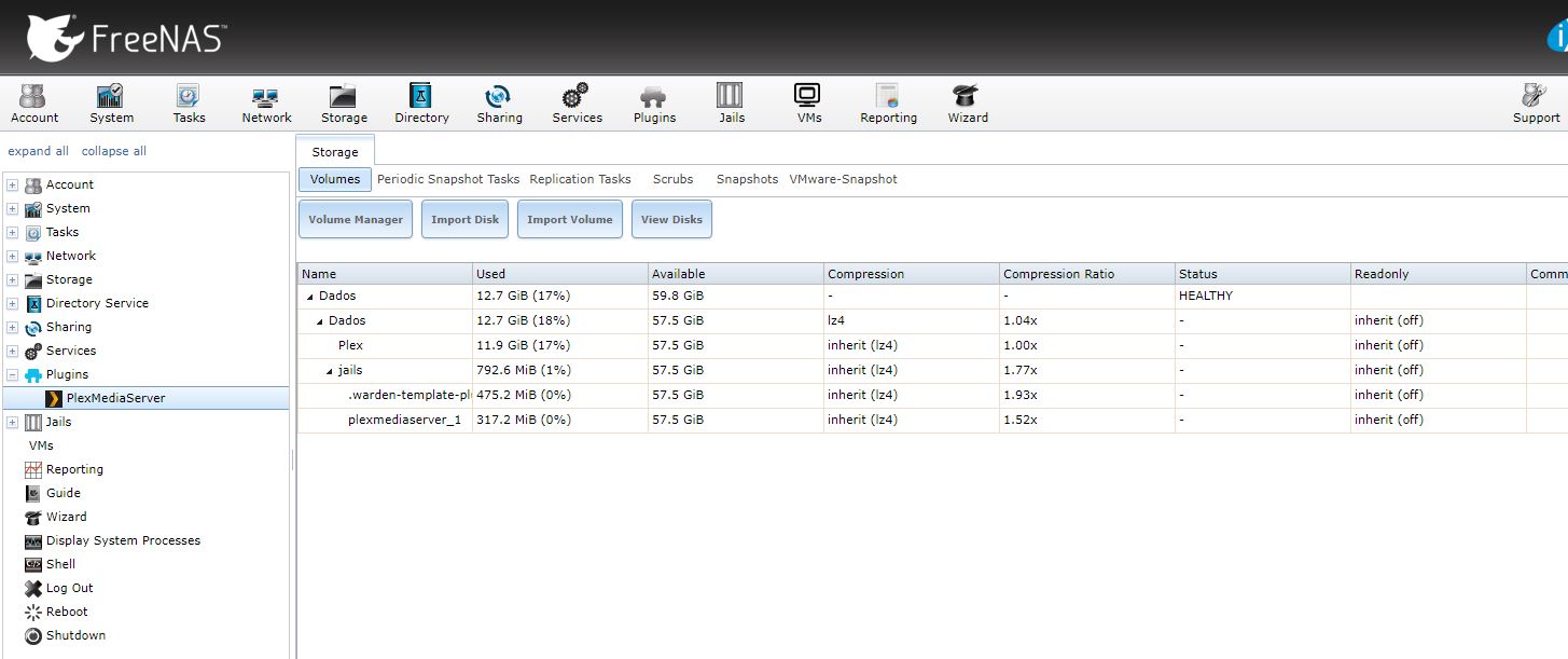

Ok, you put the pictures to check how I'm doing.

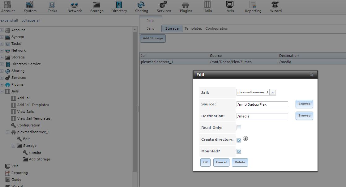

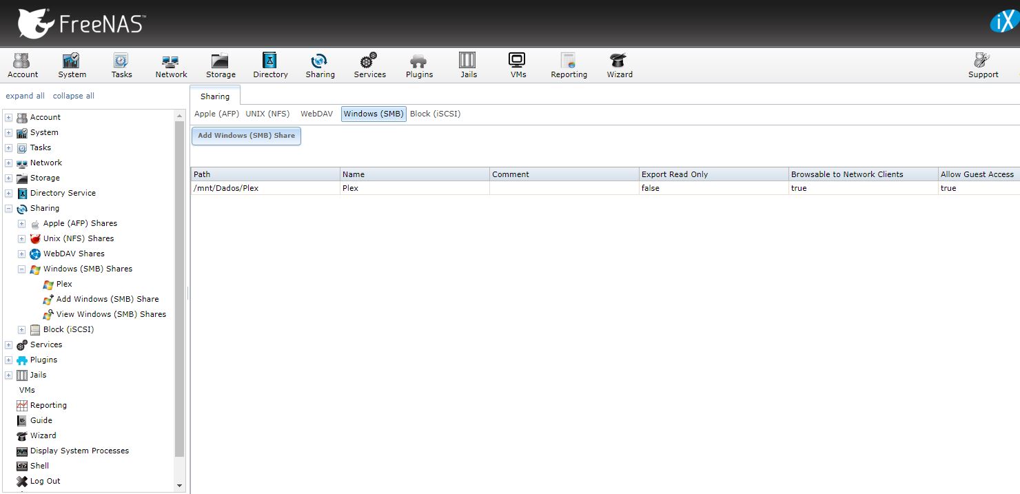

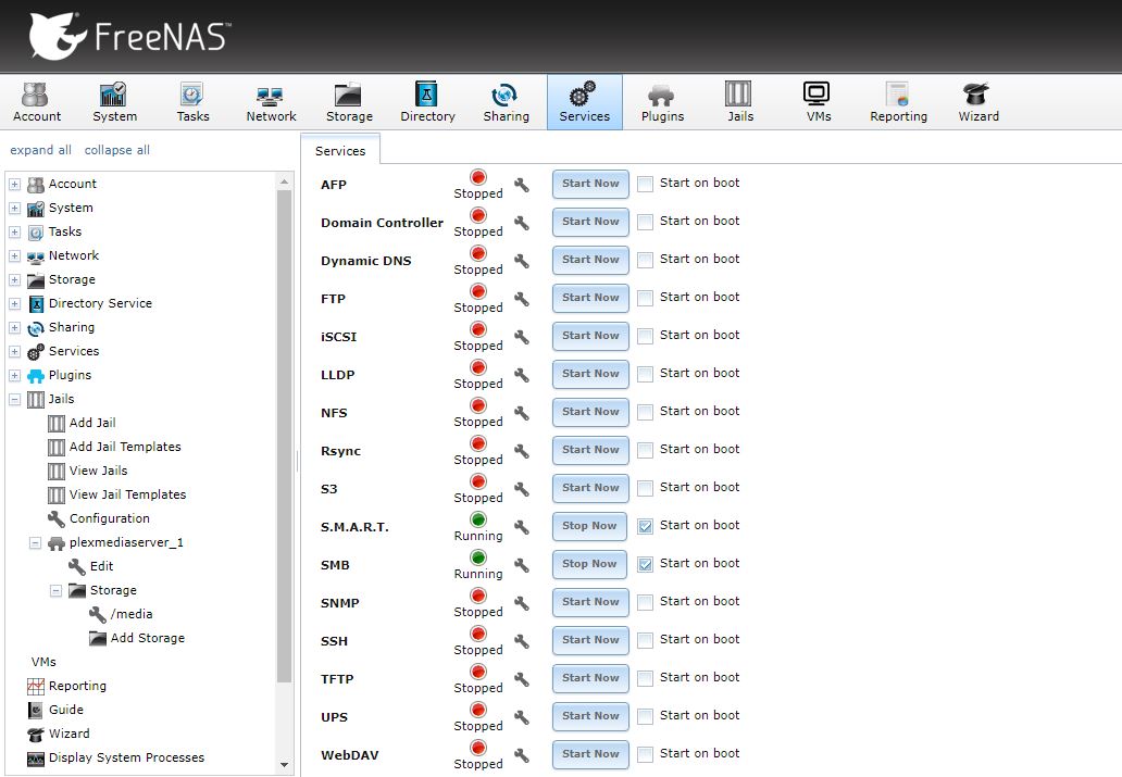

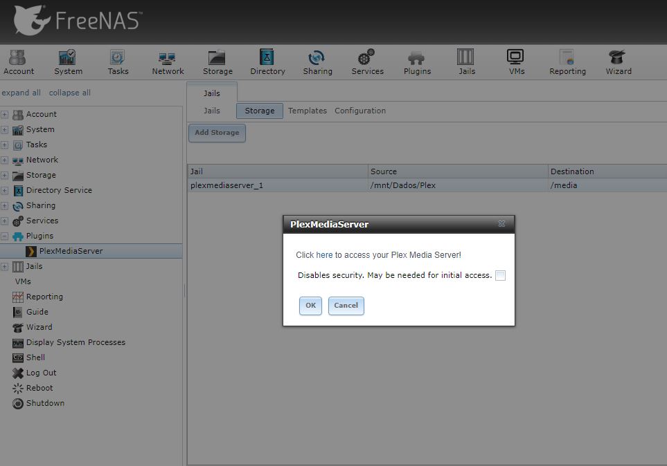

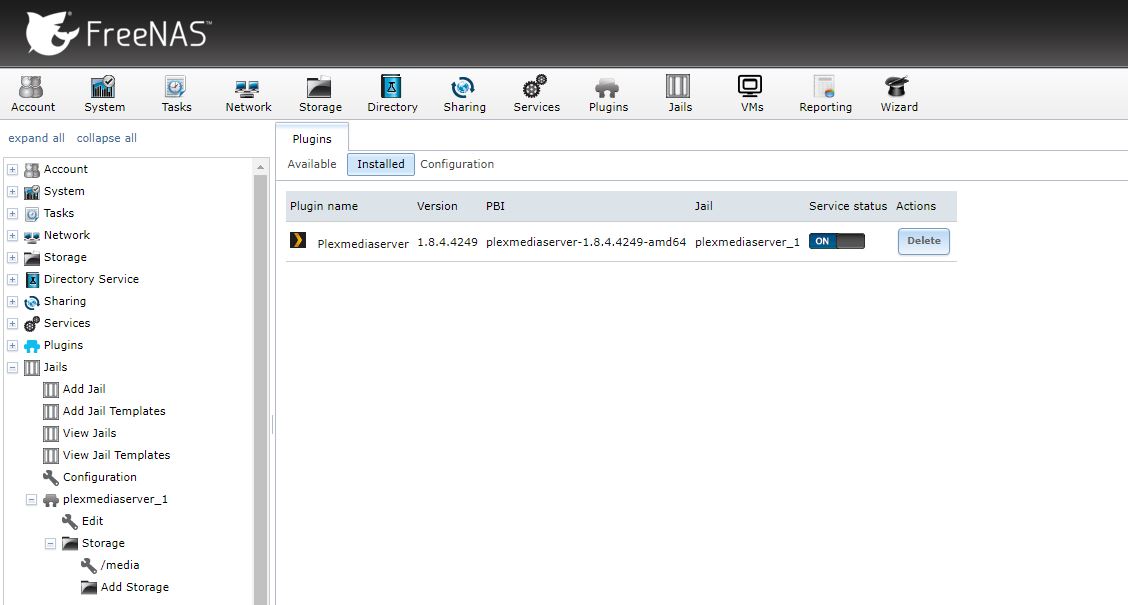

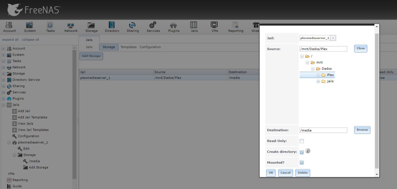

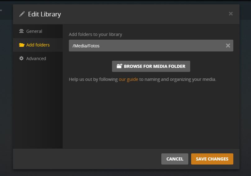

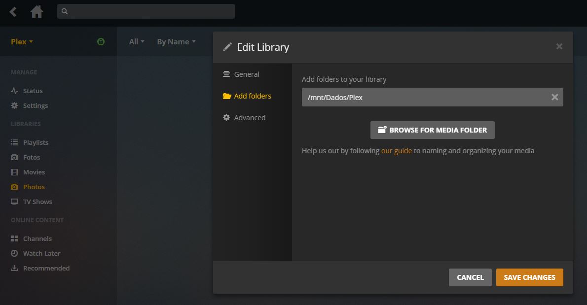

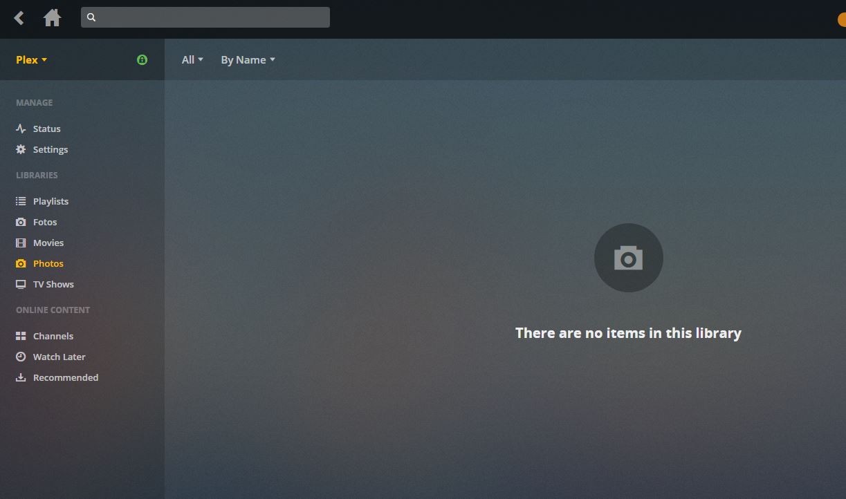

Sergioik
Apr 15, 2016
30
to be continued
SweetAndLow
Sweet'NASty
Nov 6, 2013
6,421
Super simple your using the wing path. You need to use /media since that was the destination you have your storage mount point.
Sergioik
Apr 15, 2016
30
So if that is not working.
