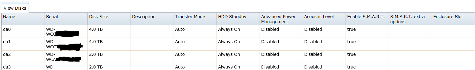

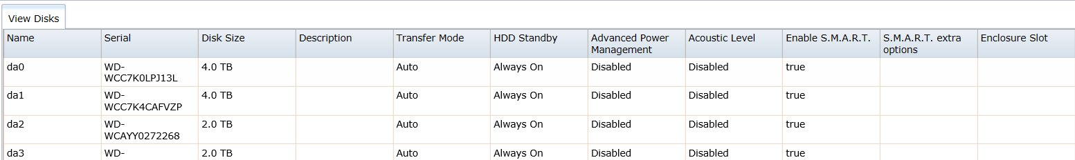

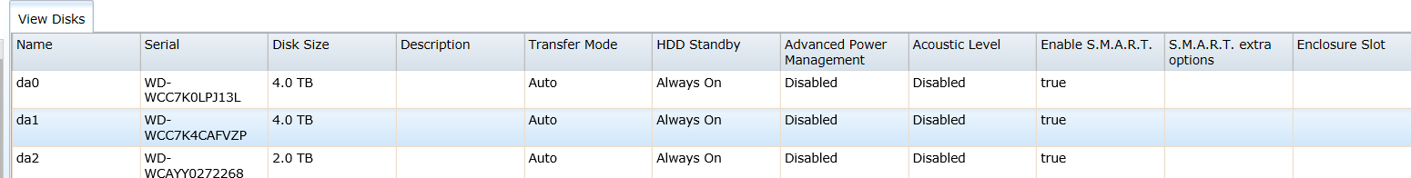

This is whats in da1
(SR#'s blanked so ppl don't mess with my warranties ;D. I know they'd need the physical drives too but I'm trained to be paranioid)

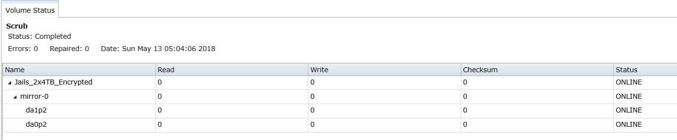

SMART reports no errors on that drive.

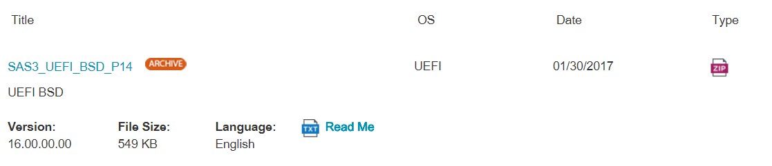

I'm using an LSI AS 9300-4I HOST BUS ADAPTER
Latest firmware is P14 but I'm running P13 (haven't requested a maintenance window to upgrade it, I will if that's the fix).

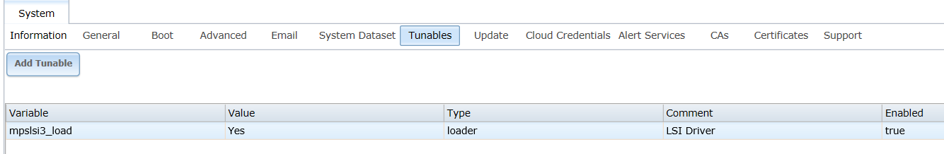

I'm also running this tunable. It's a leftover from freenas 9.2 days. Not sure if its still relevant in Freenas 11x days but I figure if it aint broke, why fix it? :p
Get rid of it I doubt it's doing anything, but it's needless clutter.
As for the firmware, definitely update it. What is more urgent, however, is to ensure that the backplane (not the HBA) is running the latest firmware.

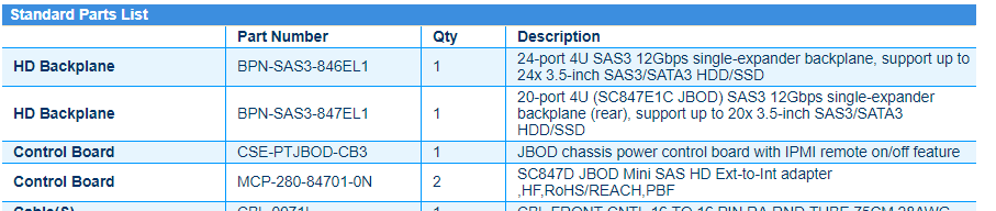

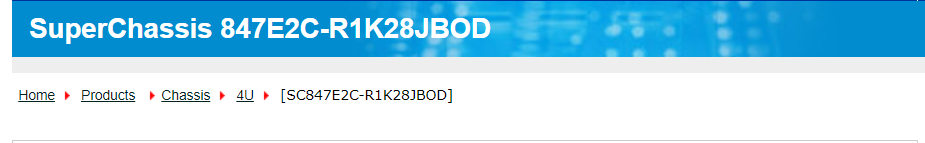

I'm running a external jbod:
Try as I might, I've never been able to find a firmware updates for the two backplanes in the chassis:
Searches on the supermicro site including their FTP had no luck.
I'll upgrade the LSI firmware during my next maintenance window and see if that fixes the error message.
Thanks for the prompt replies!
