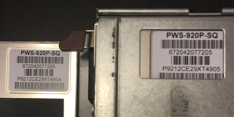

Case: CSE-826BE16-R920LPB/SC826E16-R920LPB with BPN-SAS2-826EL1 and 2xPWS-920P-SQ ($145)

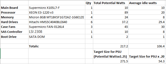

Now I am trying to get a handle on what the total idle power consumption will be. Below are my estimates:
X10SL7-F: (could not find specific numbers for the board itself)
E3-1220 v3: 20 watts total
MT18KSF1G72AZ-1G6E1ZE: 4x2watts 8 watts total??
HMS5C4040BLE640: 6x4.9 watts 29.4 watts total
2308 Controller: 8 watts total
SATA-DOM: 1 watt total?
PSU: ??
FANS: 10 watts total??
I have been searching the net/forums to gather the info but coming up short on some of the numbers. So I am coming up with roughly idle 76.4 watts with just the numbers above but not sure how accurate that is so please correct me where ever I am wrong. I know this will may consume more than my current Microserver setup, but hopefully not much more.

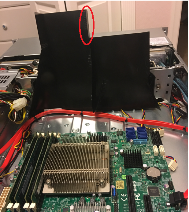

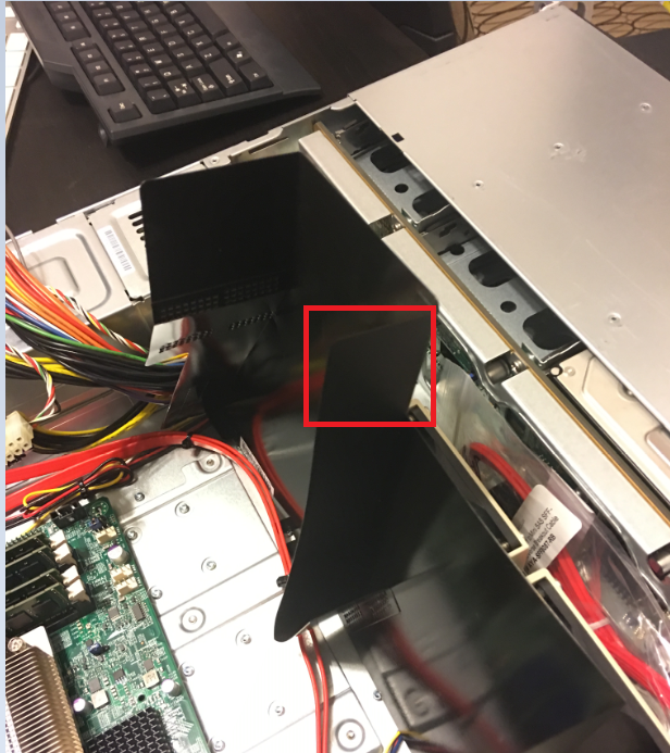

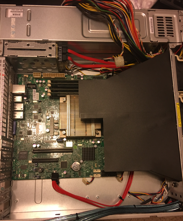

Also, saw a post about the ATX 24pin and 12v 8pin connectors from the power distributor possibly being too short? So wondering if I may need
to get extenders for those. I know in the post by mattbbpl(https://www.ixsystems.com/community/threads/build-double-check-painting-by-numbers.34932/) post #33 he shows a picture of the board installed and the connectors not reaching. He states he has the CSE-826TQ-R800LPB with the 800watt power supplies which uses the PDB-PT825-8824 power distributor, whereas the case I purchased with the 920watt power supplies has the PDB-PT826-8824 power distributor. Is it possible that the connector lengths are different depending on the PD you get? Have not seen any other posts in regards to the connectors being too short when installing the X10SL7-F in a CSE-826 case so any feedback from anyone on this topic would be greatly appreciated as well!
