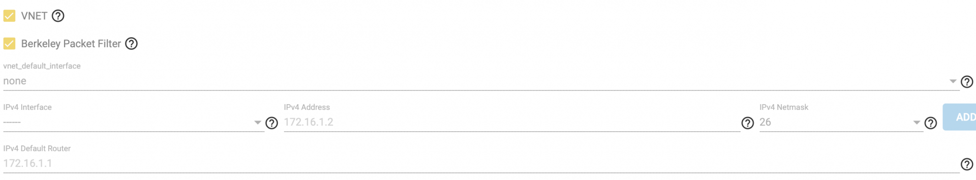

Is something wrong with vnet setup? In my case jails use following setup (of course with different IPs and interfaces set to vnet0:bridge11):
Could this configuration may affect caddy's build (0.0.0.0:443: connect: connection refused)?
