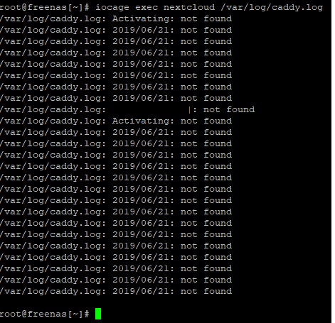

15,504
Caddy isn't running and it doesn't start when I use the start command.
Does it give any error output? If not, is there anything in /var/log/caddy.log in the jail?

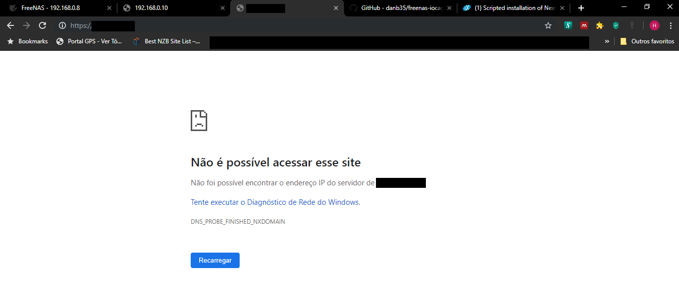

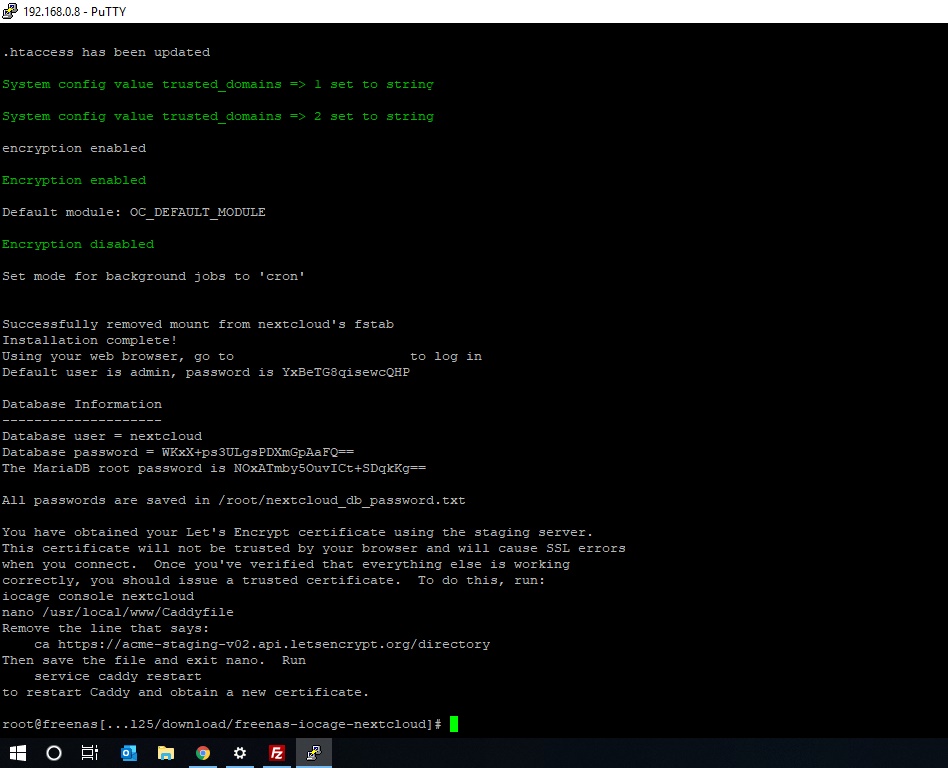

neto_hugo
Mar 6, 2012
87
Hey,
After the installation finished without any errors, when trying to access NC by the browser (with domain and by IP) always gives error ... "Can not access this site"
I can not access the NC page to put user and password
What could be going wrong?
Thank you!
neto_hugo
Mar 6, 2012
87
Sure... It's in Portuguese, if you can not understand something, let me know and I'll help you.

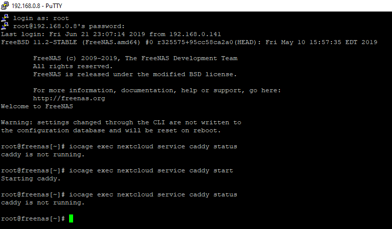

15,504
OK, looks like Caddy might not be running. Check that using iocage exec nextcloud service caddy status. If it isn't, try starting it using iocage exec nextcloud service caddy start and post the output if it fails.
neto_hugo
Mar 6, 2012
87
OK. Caddy was not running,
I activated the service and still not running...

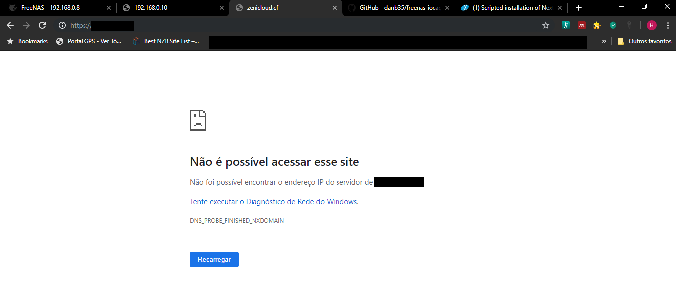

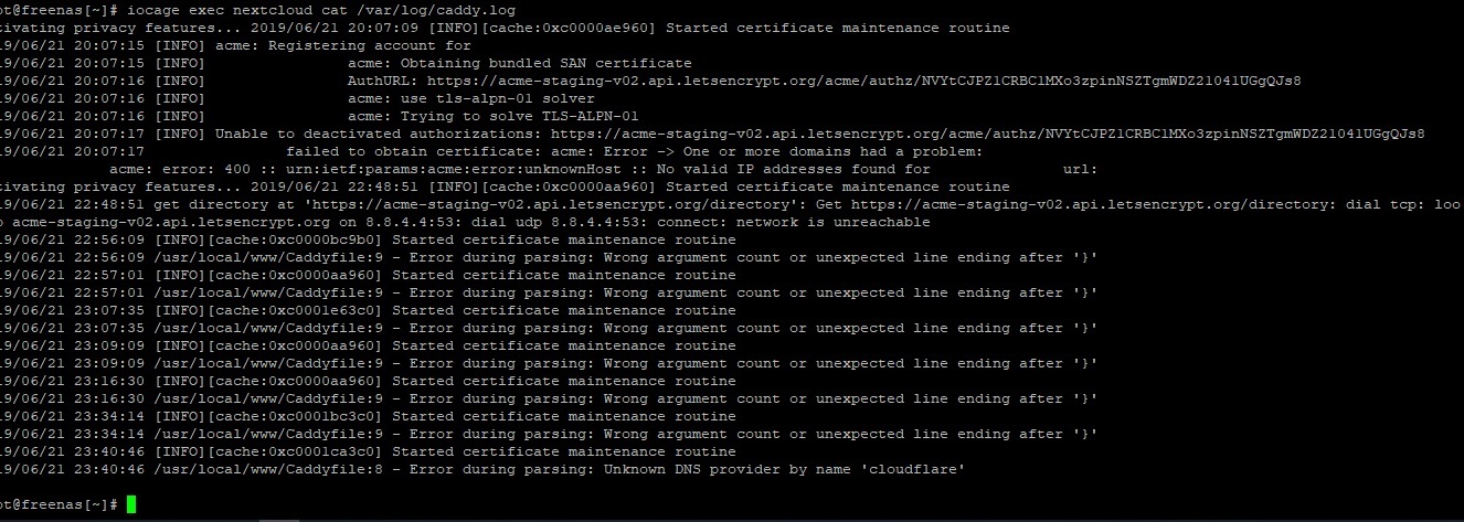

15,504
The fact that you're posting screen shots rather than text means I can't copy/paste the problem, but it looks like the problem is that your domain doesn't have DNS records--the line saying "No valid IP addresses found for ..." (and I'm assuming you redacted your domain name there). You need to have a DNS A record in place pointing to your IP address for Caddy to be able to get the certificate.

15,504
I'm also seeing an error about a missing DNS plugin, which sounds odd. What are the contents of your nextcloud-config file (edit: mask the Cloudflare credentials, if you're using DNS validation for Let's Encrypt)? And what's the output of iocage exec nextcloud caddy -version and iocage exec nextcloud caddy -plugins?
