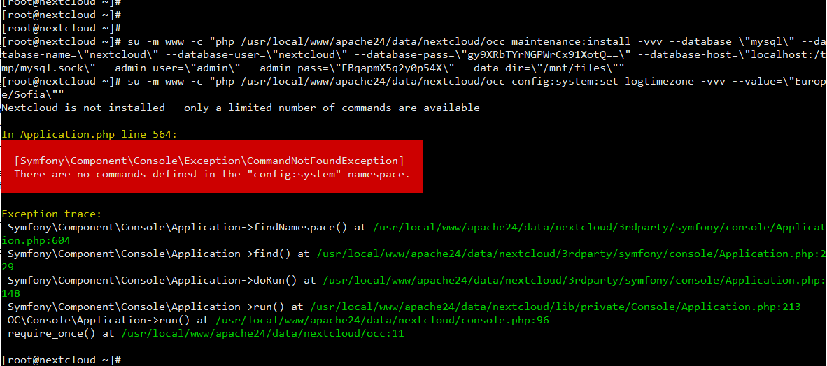

iocage exec ${JAIL_NAME} su -m www -c "php /usr/local/www/apache24/data/nextcloud/occ maintenance:install --database=\"mysql\" --database-name=\"nextcloud\" --database-user=\"nextcloud\" --database-pass=\"${DB_PASSWORD}\" --database-host=\"localhost:/tmp/mysql.sock\" --admin-user=\"admin\" --admin-pass=\"${ADMIN_PASSWORD}\" --data-dir=\"/mnt/files\""
echo "4"
iocage exec ${JAIL_NAME} su -m www -c "php /usr/local/www/apache24/data/nextcloud/occ config:system:set logtimezone --value=\"${TIME_ZONE}\""

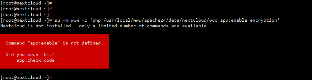

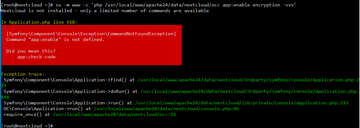

iocage exec ${JAIL_NAME} su -m www -c 'php /usr/local/www/apache24/data/nextcloud/occ app:enable encryption'

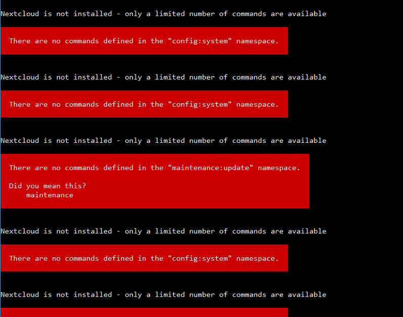

Installation and configuration of Nextcloud 1 2 3 4 Nextcloud is not installed - only a limited number of commands are available There are no commands defined in the "config:system" namespace. True 5 Nextcloud is not installed - only a limited number of commands are available There are no commands defined in the "config:system" namespace. True 6 Nextcloud is not installed - only a limited number of commands are available There are no commands defined in the "config:system" namespace. True 7 Nextcloud is not installed - only a limited number of commands are available There are no commands defined in the "config:system" namespace. True 8 Nextcloud is not installed - only a limited number of commands are available There are no commands defined in the "config:system" namespace. True 9 Nextcloud is not installed - only a limited number of commands are available There are no commands defined in the "config:system" namespace. True 10 Nextcloud is not installed - only a limited number of commands are available There are no commands defined in the "config:system" namespace. True 11 Nextcloud is not installed - only a limited number of commands are available There are no commands defined in the "config:system" namespace. True 12 Nextcloud is not installed - only a limited number of commands are available There are no commands defined in the "config:system" namespace. True 13 Nextcloud is not installed - only a limited number of commands are available There are no commands defined in the "config:system" namespace. True 14 Nextcloud is not installed - only a limited number of commands are available There are no commands defined in the "config:system" namespace. True 15 Nextcloud is not installed - only a limited number of commands are available There are no commands defined in the "maintenance:update" namespace. Did you mean this? maintenance True 16 Nextcloud is not installed - only a limited number of commands are available There are no commands defined in the "config:system" namespace. True 17 Nextcloud is not installed - only a limited number of commands are available There are no commands defined in the "config:system" namespace. True 18 Nextcloud is not installed - only a limited number of commands are available Command "app:enable" is not defined. Did you mean this? app:check-code True 19 Nextcloud is not installed - only a limited number of commands are available There are no commands defined in the "encryption" namespace. True 20 Nextcloud is not installed - only a limited number of commands are available There are no commands defined in the "encryption" namespace. True 21 Nextcloud is not installed - only a limited number of commands are available There are no commands defined in the "background" namespace. True 22
