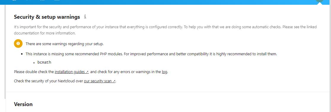

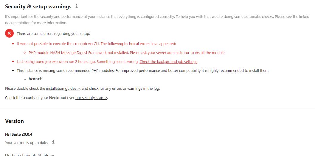

in my setting overview , there're notification like this :
Security & setup warnings
It's important for the security and performance of your instance that everything is configured correctly. To help you with that we are doing some automatic checks. Please see the linked documentation for more information.
There are some errors regarding your setup.
  • It was not possible to execute the cron job via CLI. The following technical errors have appeared:
    • PHP module HASH Message Digest Framework not installed. Please ask your server administrator to install the module.
  • Last background job execution ran 2 hours ago. Something seems wrong. Check the background job settings
  • This instance is missing some recommended PHP modules. For improved performance and better compatibility it is highly recommended to install them.
    • bcmath
Please double check the installation guides ↗, and check for any errors or warnings in the log.
Check the security of your Nextcloud over our security scan ↗.
what i have to do then ?
please more advice.

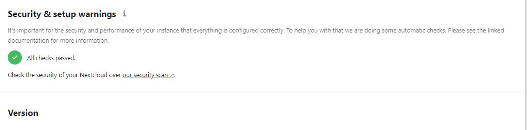

Hi mr.danb35 ,
i really realy thanks for your help .. btw Happy New Year , hope that u have a better new year.
Now, my nextcloud was running normally , without any notification now.
