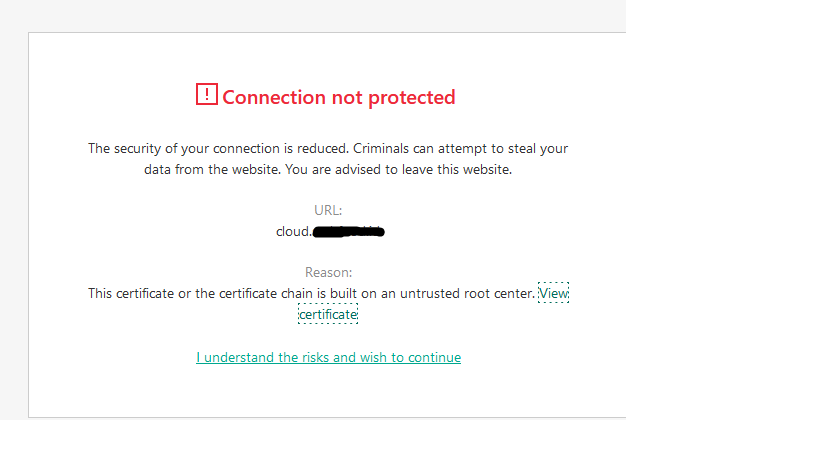

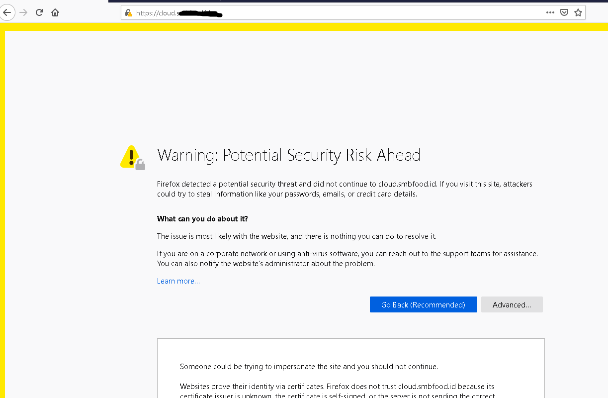

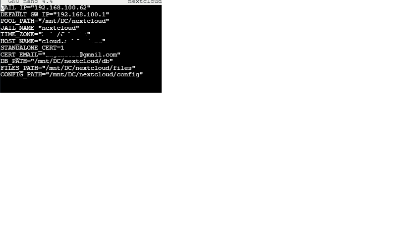

InGenetic
Dec 18, 2013
183
Hi Mr.danb35,
How are you ? i've just build a new nextcloud on new freenas , i follow your guide .
and it's done well , i can access the my nextcloud : using my own domain and has an ip public address direct NAT forward to port 443 and 80
but, my nextcloud it seem can't get ssl from letsencrypt :
my config is like below :
how to get letsencrypt ssl right ,if the installation was done ?
Please advice,
Regards,
9,703
Are you directing/forwarding port 80 from your router to the jail IP? and does your cloud.domain.com address point to your router's public IP?
