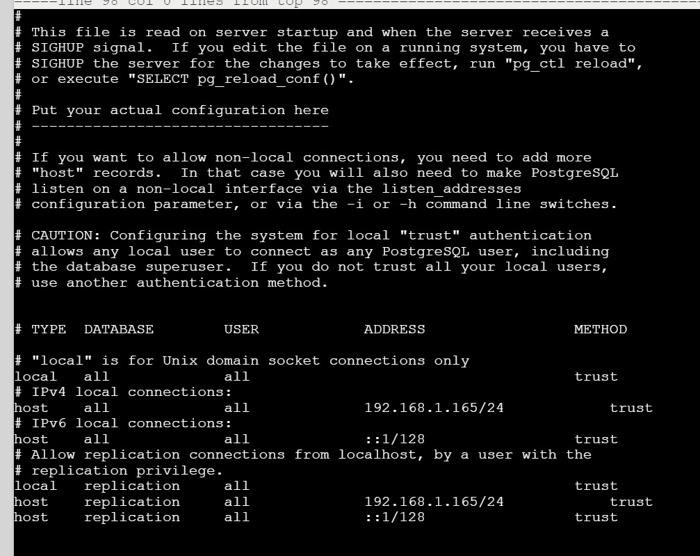

By default it will only listen on localhost. To change this, edit the file at /var/db/postgres/data15/pga_hba.conf
Find the line at the bottom where it says
# IPv4 local connections:
host  all  all  127.0.0.1/32   trust
and change the address to either your IP or 0.0.0.0/0 to listen on everything.

Thank you very much for your quick reply, but the problem still exists after I operate in this way. Maybe I am not a programmer and don't know much about its operation, but I am sure that I have modified it successfully, and I have restarted the jails.

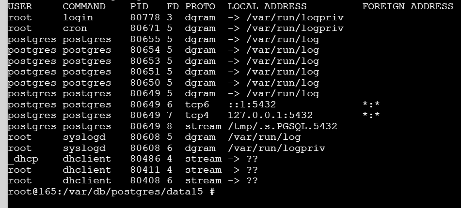

Does sockstat show postgresql listening on port 5432?

dktech
May 30, 2019
69
dktech
May 30, 2019
69
From this image it looks like it’s still not listening on the proper addresses.

And a sockstat again to see if it is listening on the right address. Also, try to remove the /24 from the address in the pg_hba.conf file.

There is no change, if deleted/24, it will prompt that the service cannot be started

Sorry about that. Change it back to what it was. I think it was 127.0.0.1/32
The file you need to edit is actually /var/db/postgres/data15/postgres.conf
Find these two lines,
#listen_addresses = 'localhost'
#port = 5432
(change listen_addresses to one of these three: '*' to listen on everything, 0.0.0.0 to listen on ipv4 only, and 192.168.x.x to listen on your IP
Uncomment (remove the # in front) the above lines then restart the service again.
EDIT: What I should have said above is that by default it will not listen on anything except the unix socket.

Thank you very much for your reply, it worked this time,
