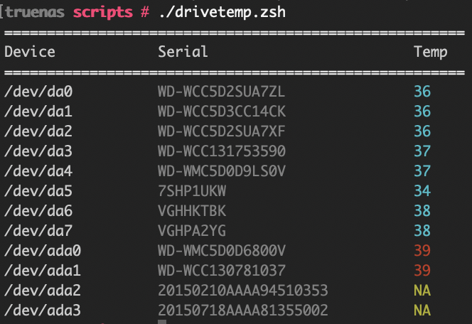

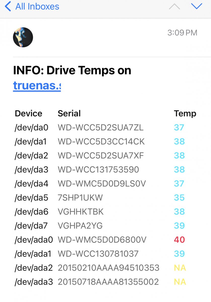

It has been awhile since I posted anything, but thought I would share this script I wrote this weekend. Before anybody asks, yes I do have SMART system alerts set to send me an email if drives exceed a certain temperature. I was just replacing the fans in my case and wanted any easy solution to periodically check drive temperatures, so I know where there might be obstructions from wiring, etc. I wanted the output to include the dev location, serial number (to make investigation easier) & the temps. You can set the max temp you want to be warned about in the script. I have 7200rpm drives and 40 degrees really is the max I'd personally like to see. Since some SSDs/DOMs don't have temp sensors, the script will display those with a temp of NA. This will detect da/ada/nvme devices. You can also set the max temp of SSD's. If you have any issues with it please let me know by including the output from the script on your system and I will do my best to address.

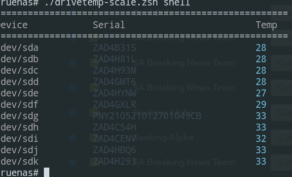

Update 2021-06-23:
* added version compatible with SCALE
Update 2021-03-25:
* unified script to be able to run in the shell or run as a cronjob (just run the script the script like ./drivetemp.zsh shell or ./drivetemp.zsh email)
* you can now set the max temp of your SSD's in the script since they tend to run hotter

SCALE

Rudi Pittman
Dec 22, 2015
161
The scale version gives errors with cut/paste. Can you not upload to somewhere like pastebin and provide a link? They have a raw mode that makes cut/paste much easier.
j_r0dd
Jan 26, 2015
134
Rudi Pittman
Dec 22, 2015
161
Thank you! The colors are a bit hard to read though?
