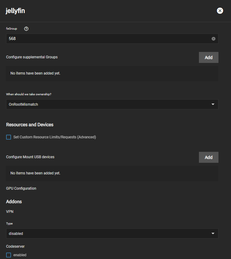

In Kubernetes settings GPU support is enable. Nothing is showing when I try to use it for Jellyfin only the label "GPU Configuration" but ther are no inputs.

SCALE only includes the required GPU support for Nvidia and Intel. No AMD GPU support is included.
It might be best making a Jira suggestion for it and calling it a day. Even if you install the required drivers and device plugin(s), it would still not shop up in the GUI anyway

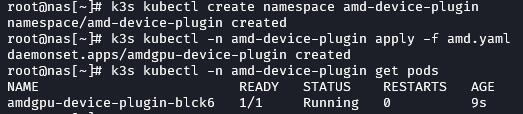

Now you can check if the plugin runs:
k3s kubectl -n amd-device-plugin get pods

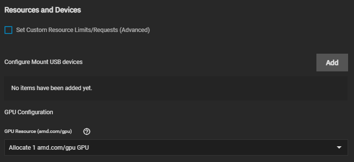

You should see something like in my screenshot below and the UI should detect the plugin. Let me know if you run into ay kind of issues.
Congrats on your first kube experience :).

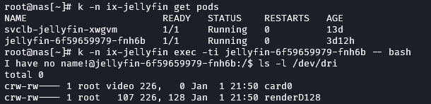

I have it show up exactly as you have under GPU configuration now :smile:. Even inside jellyfin pod /dev/dri has card0 and renderD128. And I did understand what I was doing. Learned allot. Kubernetes documentation is actually good for beginners there is just so mutch to go through new concepts and lingo https://kubernetes.io/docs/tasks/tools/. Need to take a brake and continue this next weekend.
But guess I have to wait for jellyfin to update the driver in the container to actually make use of the GPU.
