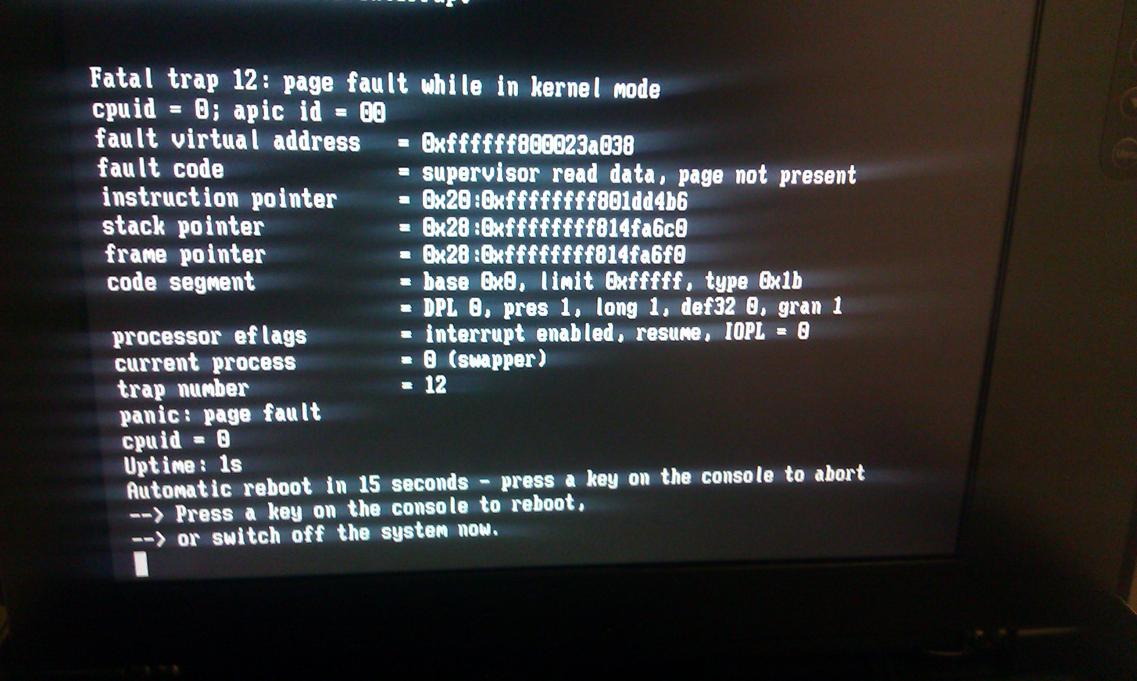

Hi all,
I have an HP DL 100 G2 NAS, and am running FreeNAS on it.
The device hangs on boot, unless I choose safe-mode.
I have been using 0.7.2 for some time, and have now upgraded to FreeNAS-8.0.2-RELEASE-i386 (8288) and the problem remains (see 'screenshot'). Even the installation CD only boots with 'option 3'.
I'd be happy to provide more information that would help you to fix this; in the meantime, it'd be very happy if someone could tell me how how to make my NAS boot into safe-mode by default (eg after a power outage).
Thanks a lot in advance,
Frank

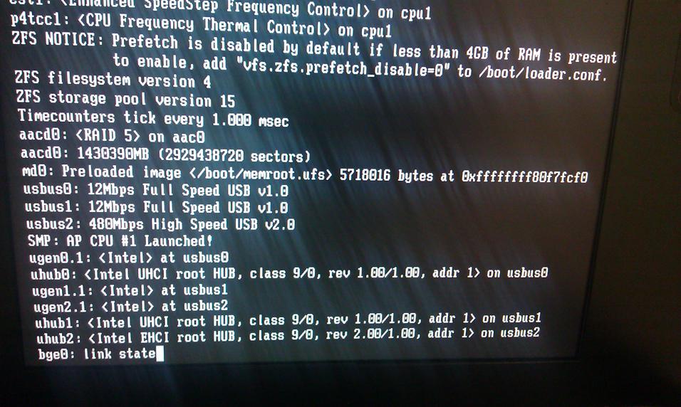

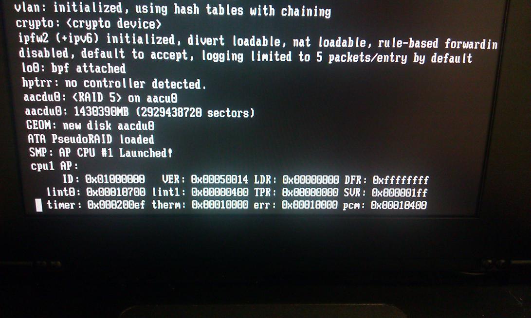

Thanks Bohs,
I have tried the amd64 image: it doesnt' even boot into safe mode. (see screenshots, the first one is safemode and the other one is 'verbose logging')
Interestingly, in safe-mode, it freezes almost immediately. In verbose or normal mode, it boots/probes/inits much farther...
Any other ideas?
TIA,
Frank

Just thought of something - How much RAM do you have in it? If I remember my readings from this forum correct you need to tweak it before installing if you run less then 4GB ram - might be wrong here though. But if correct, this could be the issue (always had 8gb on my freenas box, so didn't pay that much attention to it)
Digidoc
Oct 30, 2011
41
If you haven't done so yet, update the firmware/bios on the system. Also, disable hyperthreading as well if that cpu has it. I could be wrong here, but it looks like the system is faulting when freenas is polling the cpu capabilities, and comes back with an error when it detects the second core.
I just checked the specs of your unit on hp's site and it states its a dual core cpu (nothing about hyperthreading). In the bios there may be an option to disable SMP/multi-core operation. if you disable it and everything works fine afterwards, check the seating of the heatsink. Theres also a remote possibility that you could have a defective cpu (I've seen it happen already on an HP DC7800 desktop).
