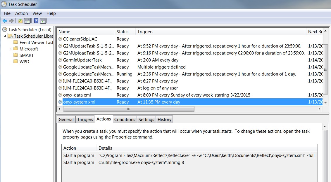

Or, if you want to ditch Deltacopy & rsync altogether, consider using the free version of Macrium Reflect to backup your PC directly to an SMB share on your FreeNAS box. It's what I use.

So can you walk we through the high level of this ... how you use Macrium. I create an SMB share on Freenas and 'Mount' it in windows. I use Macrium to 'backup' my normal files to that SMB share? Is that the idea?
Spearfoot
He of the long foot
May 13, 2015
2,478
You're exactly right.
I created a FreeNAS dataset called... wait for it... 'backups'! I set it up as an SMB share. Then I create a folder in this share for each Windows PC on my network. I direct Macrium Reflect to store its backup images there. Reflect has a scheduler, but I prefer to run it from Task Scheduler. Reflect stores backup jobs as XML files in your user folder; you'll need to run it and set up appropriate backup job(s) for your needs. In my case, I run two jobs: a daily full system backup of my Windows boot disk, and a weekly full backup of my larger 'data' disk (which contains mostly VirtualBox VM images that don't change often 'cause I hardly ever use them). Here's a screenshot of the Task Scheduler setup for my main Windows workstation, 'Onyx':
...where you can see I call Reflect and pass it an XML file to run a backup. The 'file-groom.exe' program is a utility I wrote that's similar to rollogs, i.e., it deletes older backup images so that they don't fill up my NAS!
I can't recommend Macrium Reflect highly enough: it's saved my bacon at least once. It makes it simple to restore a system image to a new drive. It let's you create a bootable ISO/CD/USB disk custom-tailored for your system that will let you restore an image over your network. The only thing the free version doesn't do that I wanted is the file maintenance, which is why I wrote the file-groom utility I mentioned.
Basicallly, 'It Just Works', as Jerry Pournelle used to say.

FreeNAS only provides storage in this scenario, not any kind of file management. All modern file servers: FreeNAS, FreeBSD, Linux, Windows, etc., can be configured to provide SMB storage. But we can't expect them to automatically manage our files for us. In this case, we're writing backup files to an SMB share: how is the SMB server supposed to know which files we want deleted, and when to delete them?
Reflect runs on your Windows PC and creates a backup of your system drive(s) as a single file. It creates another backup file each time you run it, so these files will accumulate over time, and they're large, so we need to regularly delete older versions. But FreeNAS, or any other server, doesn't have anything to do with managing these files; that's up to us. Now to be clear, FreeNAS does provide tools allowing us to manage files: in this case we could set up a scheduled chron task to delete the older backup files. But the burden is on us to set this up; not on FreeNAS or indeed any other server operating system.
Snapshots don't have anything to do with this. They are a FreeNAS feature, used to keep archival snapshots of the ZFS filesystem, which incidentally can include our backup dataset, depending on how the snapshots are configured. This allows us to retrieve past versions of existing files, and with replication, allows us to backup the FreeNAS server itself. But they don't have anything to do with directly managing our backup files.
For my Windows PC backup strategy, I chose to use the file grooming program I mentioned above to take care of deleting older backup files, like this :
  • Every night at 11:35PM: run Macrium Reflect to create a new "Drive C:" backup, then run file-groom.exe to delete "Drive C:" backups more than 8 days old.
  • Every Sunday night at 8:00PM: run Macrium Reflect to create a new "Drive D:" backup, then run file-groom.exe to delete "Drive D:" backups more than 15 days old.

Yes, sir, you're completely missing my point. :)
FreeNAS isn't backing up your PC, and it's not automatically grooming your backup files.
Yes, SMB is a service provided by FreeNAS; it delivers access to storage; storage which is based on ZFS. And that's all we're using FreeNAS for here: storage.
The file administration I'm talking about has nothing to do with snapshots. It's simply file management. In this case, deleting old files which we no longer need or want because they're outdated.
Here's the sequence of events:
  • Reflect creates a backup image of your windows PC, which ends up as a single file, stored on a dataset accessed via the SMB service on your FreeNAS server. This backup file contains a full image of your Windows PC disk(s).
  • Each succeeding time you run Reflect, it creates another backup file, stored on your FreeNAS server alongside previous backup files. Again, each backup file contains a full image of your Windows PC disk(s). Over time, these rather large files will accumulate, using up vast amounts of storage. Which means that you must delete older backup files, else they will fill all of your storage. Which is why:
  • I run the file grooming program, which deletes these older files.
But you can handle the issue of deleting these older files in other ways:
  • Ignore the problem until your NAS is full; then delete the old files.
  • Mark your calendar to periodically remind yourself to delete the old files.
  • Set up a chron job running a script to delete the old files.
But again, snapshots are completely unrelated to any of this...
Hope this helps!
