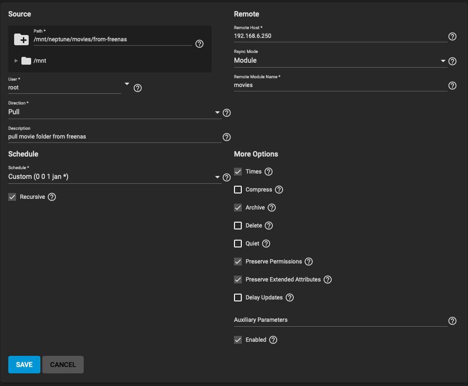

I have created a read only rsync module on the source server.
Then an rsync pull task on the destination server.
Link is 10Gb fiber.

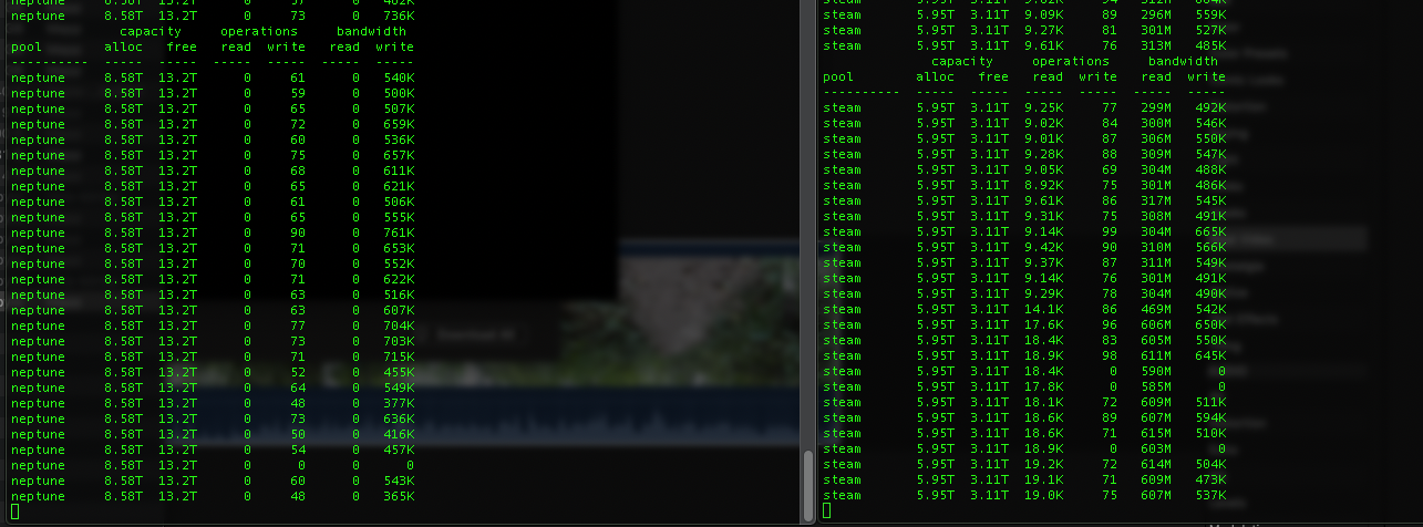

The zpool iostat is showing 300MB/s reads and 300MB/s outgoing on the NIC on the source server.
On the destination/pulling server I have 300MB/s incoming on the NIC but no writes to the pool.
I set up and started another pull and am getting 600MB/s everywhere but still no writes on the destination pool.

UPDATE: The first rsync task just finished but with a FAILED flag. Folders are written on the destination but no files. The rsync tasks are run as root.
UPDATE2: I changed the user for the rsync task to my user that have ownership of the source and destination datasets and folders but it still isn't working.

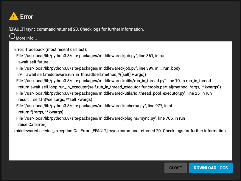

This is the error I got when it failed.
