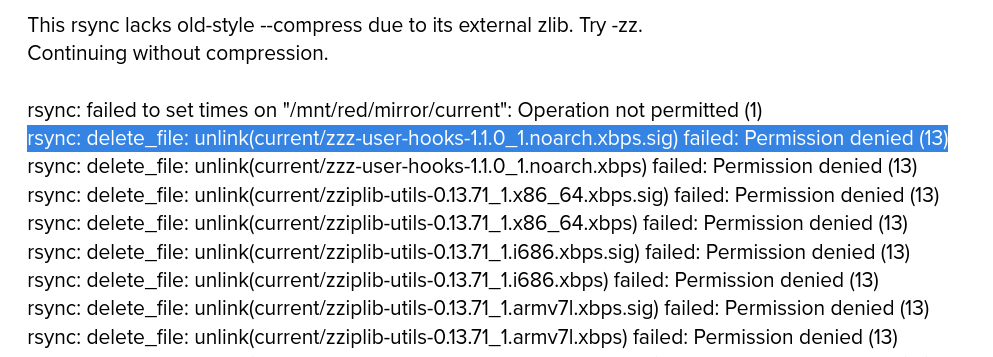

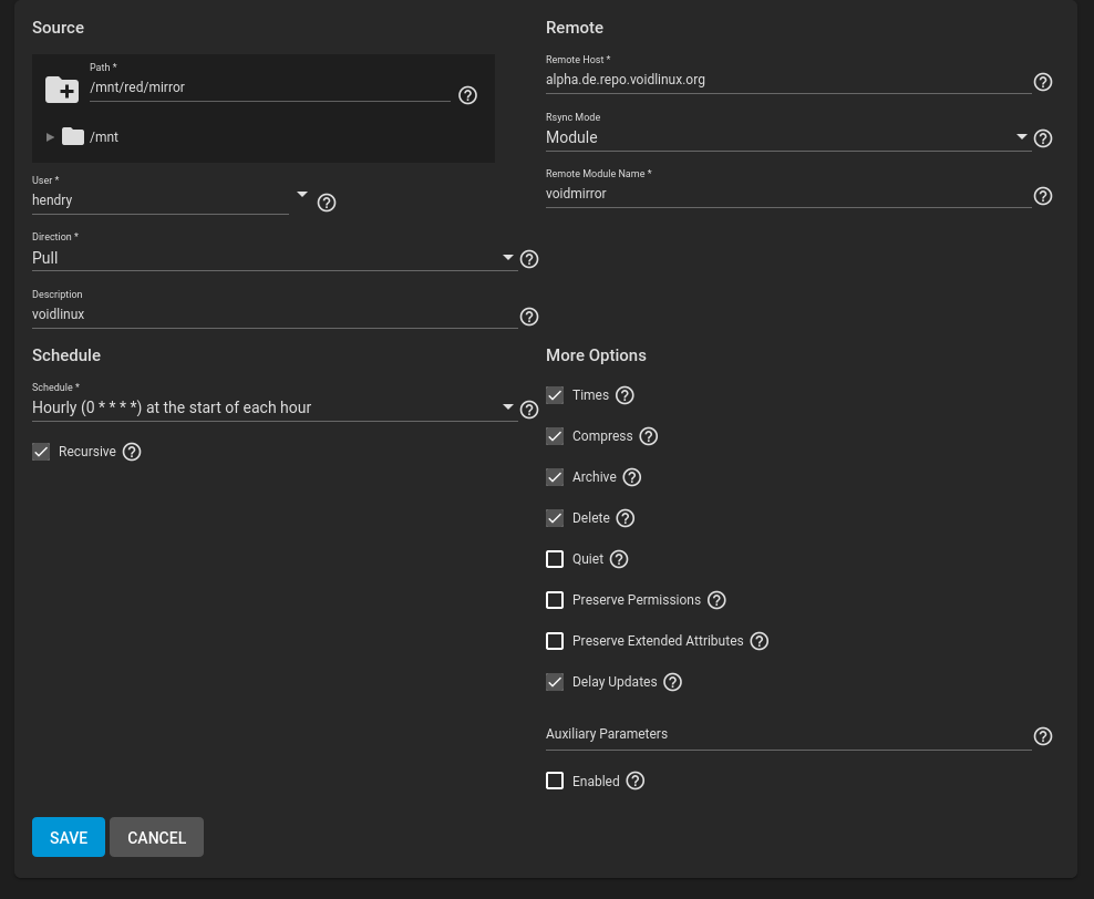

Hi there, I run a mirror for a Linux distro like so:
However I've only recently discovered thanks to finally getting a mail service configured that rsync was failing to delete old packages:

I'm not sure what my tact now is to resolve this permission problem. Would "Preserve Permissions" help, I wouldn't think so.

Hmmm... 998 is the owner's user and group ID in the directory listing above. These must be coming from the Linux server, as TrueNAS 12.x doesn't have a user or group with an ID of 998. Perhaps creating a user account on your TrueNAS/FreeNAS system with UID and GID both set to 998 will help with your problem?
